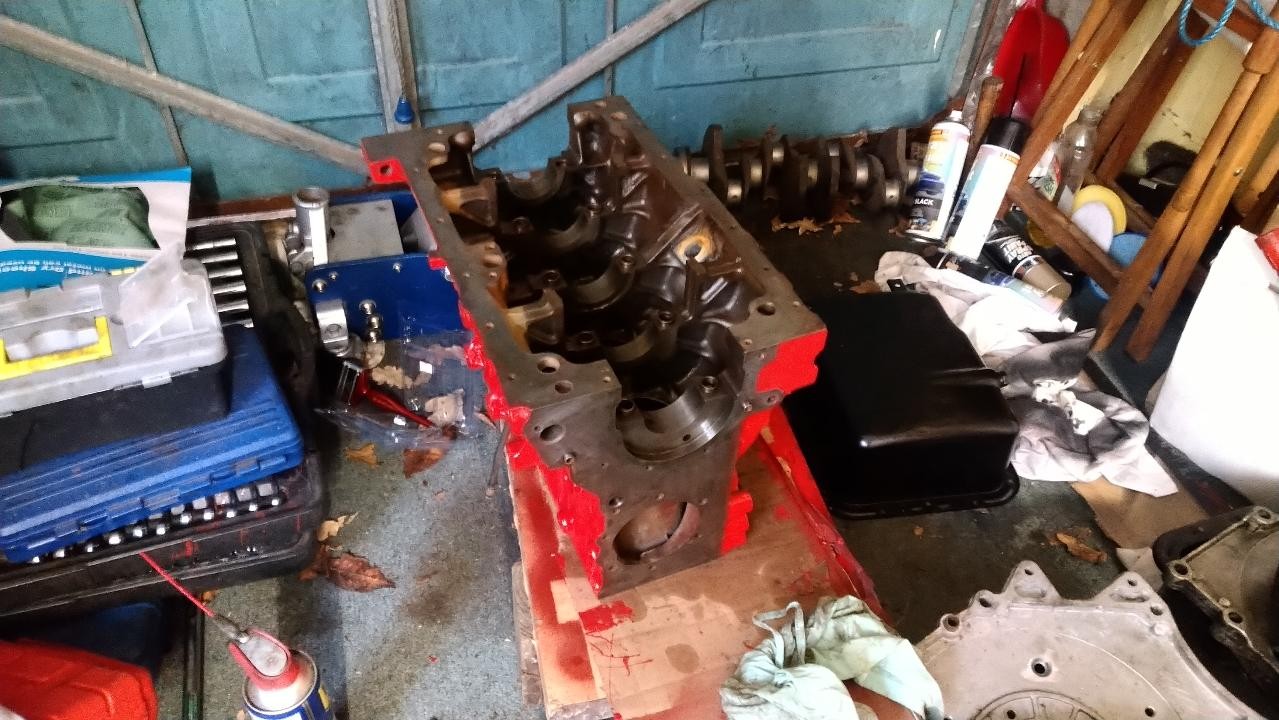

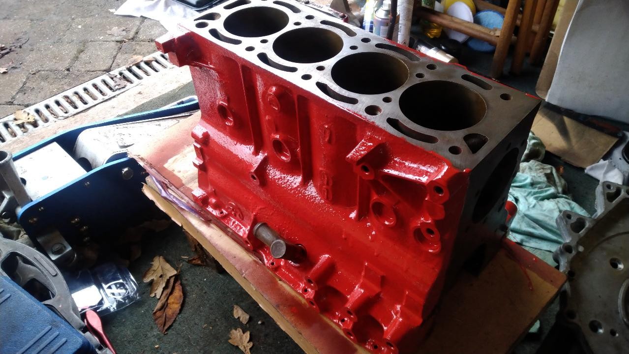

  • Bottom end ready to put back together tomorrow after the paint dries
    • Conversion from 105 carb engine to Turbo all done and now waiting for the head to be done

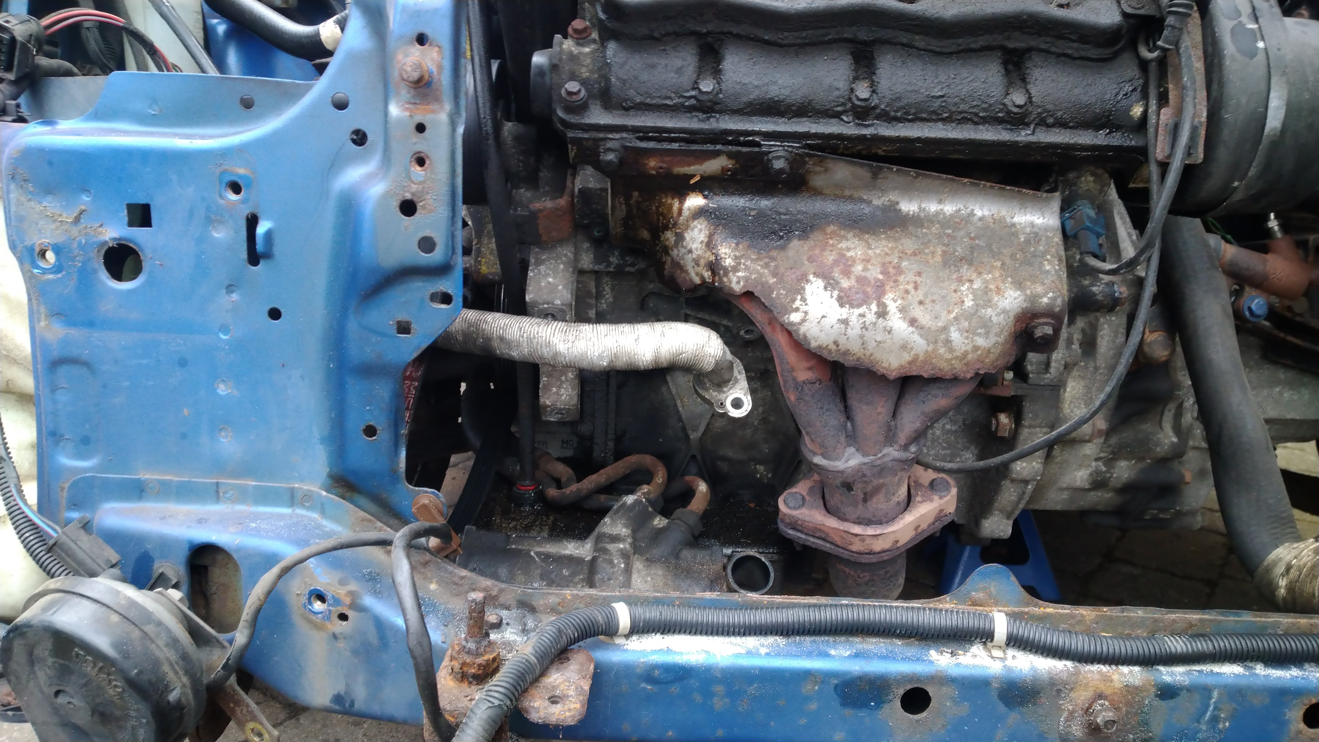

                  Have to finish his ZS180 first. The front of the car has to come off for me to replace the air con system in the engine bay as it's knackered, then find the petrol leak at the rear of the car. I've already sorted the MOT, welding it needed so it's a good job I love him
                    rather you than me...aircon is no fun at all, mystery petrol leaks can be a horror show too...
                    • Yep, can concur with that, compressor, condenser, dryer and two pipes knackered. Fuel leak is the fuel filler pipe and i'm not looking forward to doing that as most of the bolts and screws haven't been moved for 20 years

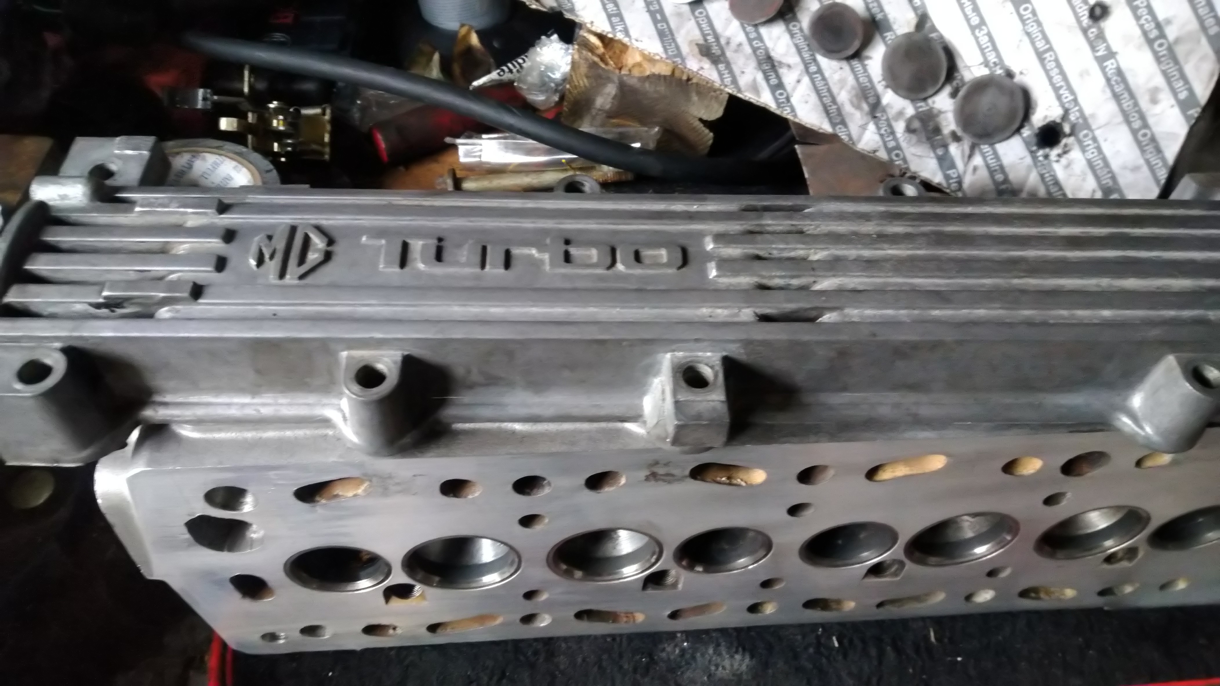

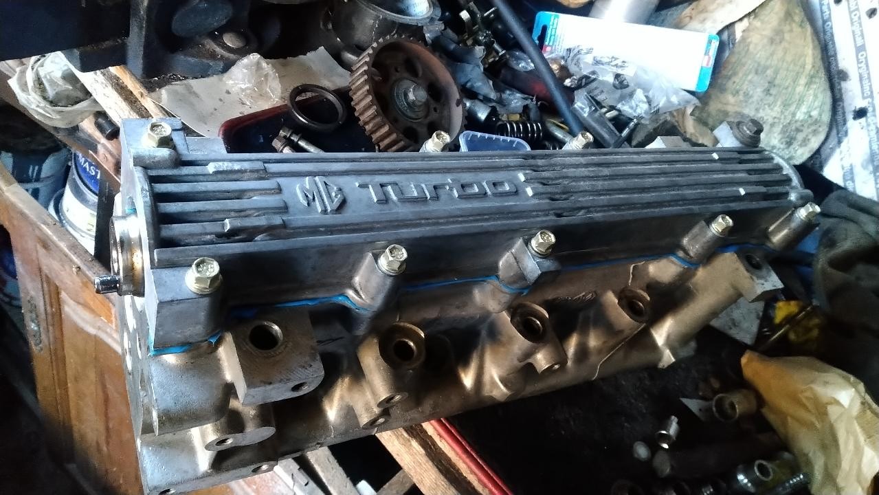

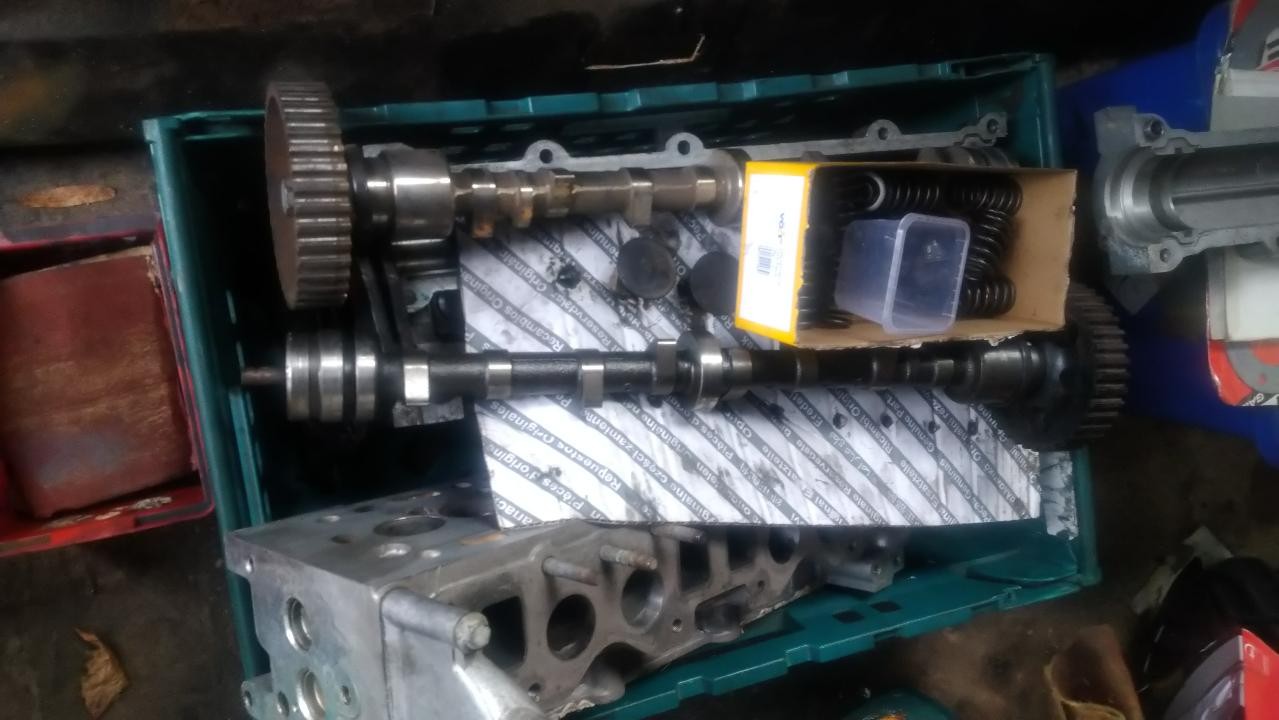

                      • Had a bit of time to clean up the head before putting back together.
                        Won't win any awards but has to be done.
                        All threads cleaned up, valves cleaned enough, new bolts found, all surfaces flattened. Bolts are the same as a Morris marina head.

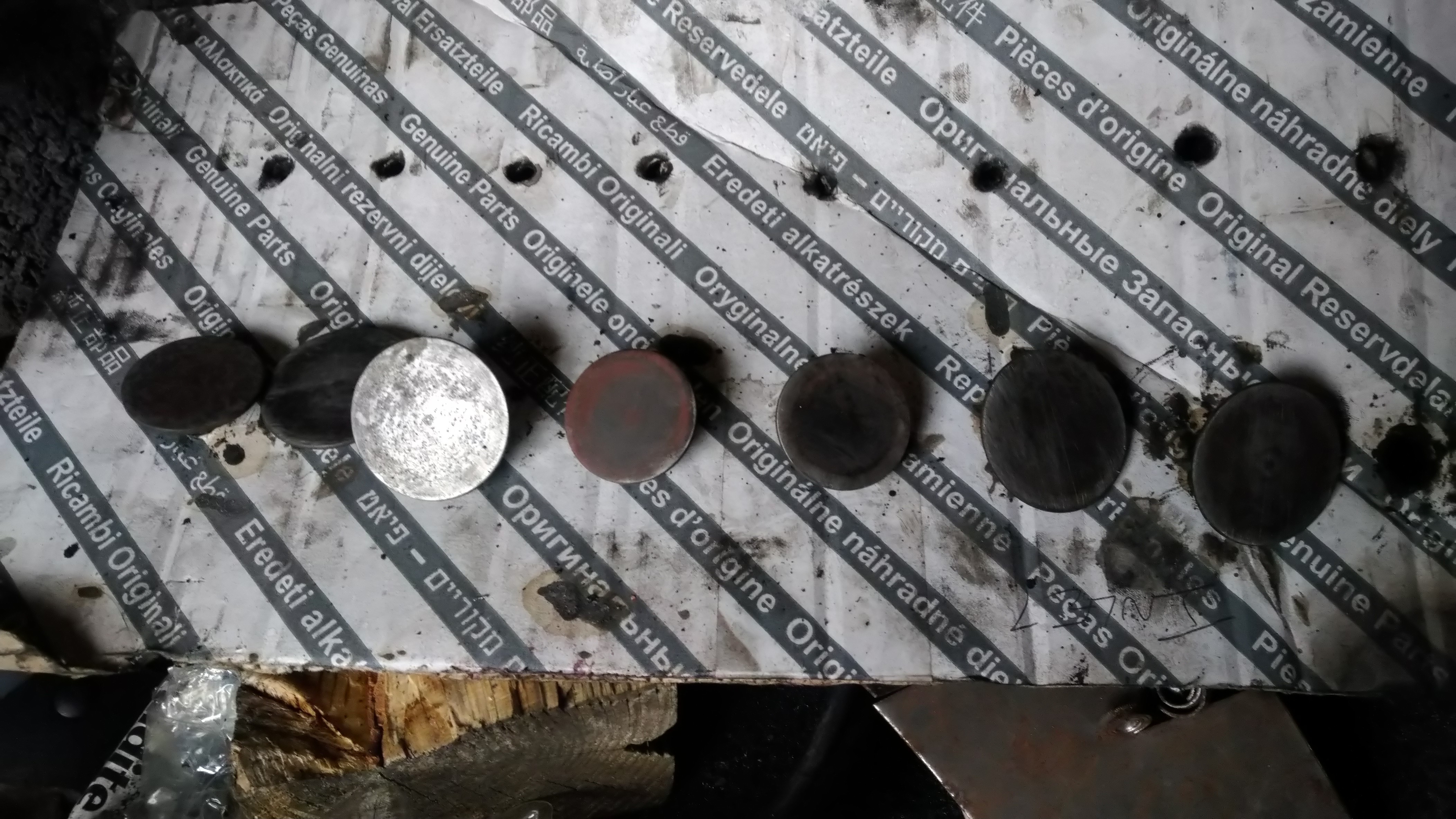

                          • Heads back together and what a pain to put the collets in as the holders were mixed up, one bolt at the back isn't long enough to tighten so I have put an old bolt in for now and will replace it later. Waiting for the sealant to go off before the next bit

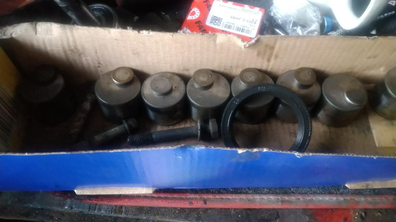

                            • These days there are three sorts of stem seals. Original has the brass surround and cup underneath, new are without the brass surround, face lift with later engines have all as one piece. Unfortunately the new stem seals I had were the older type so I had to strip down the old head and get the cups out as the existing were the later type.

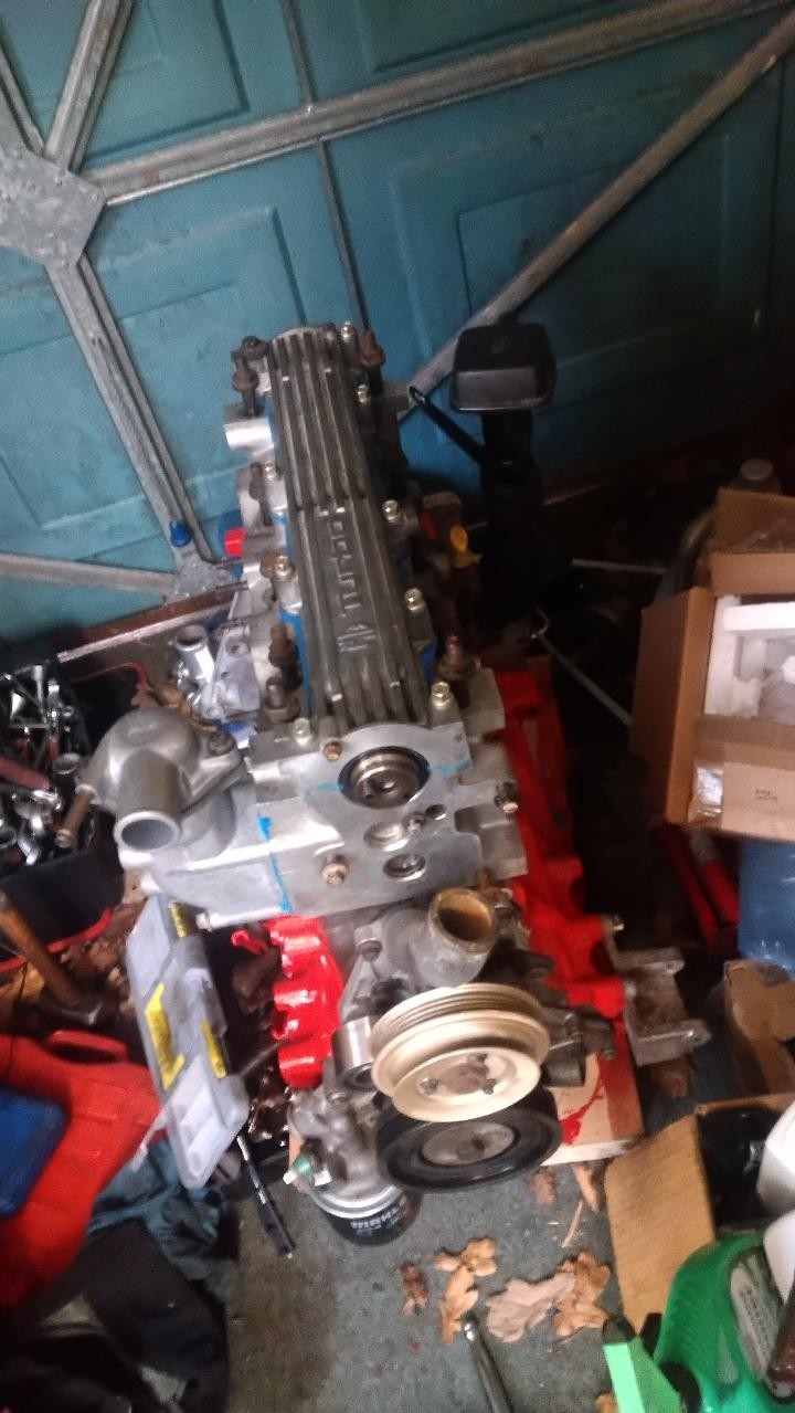

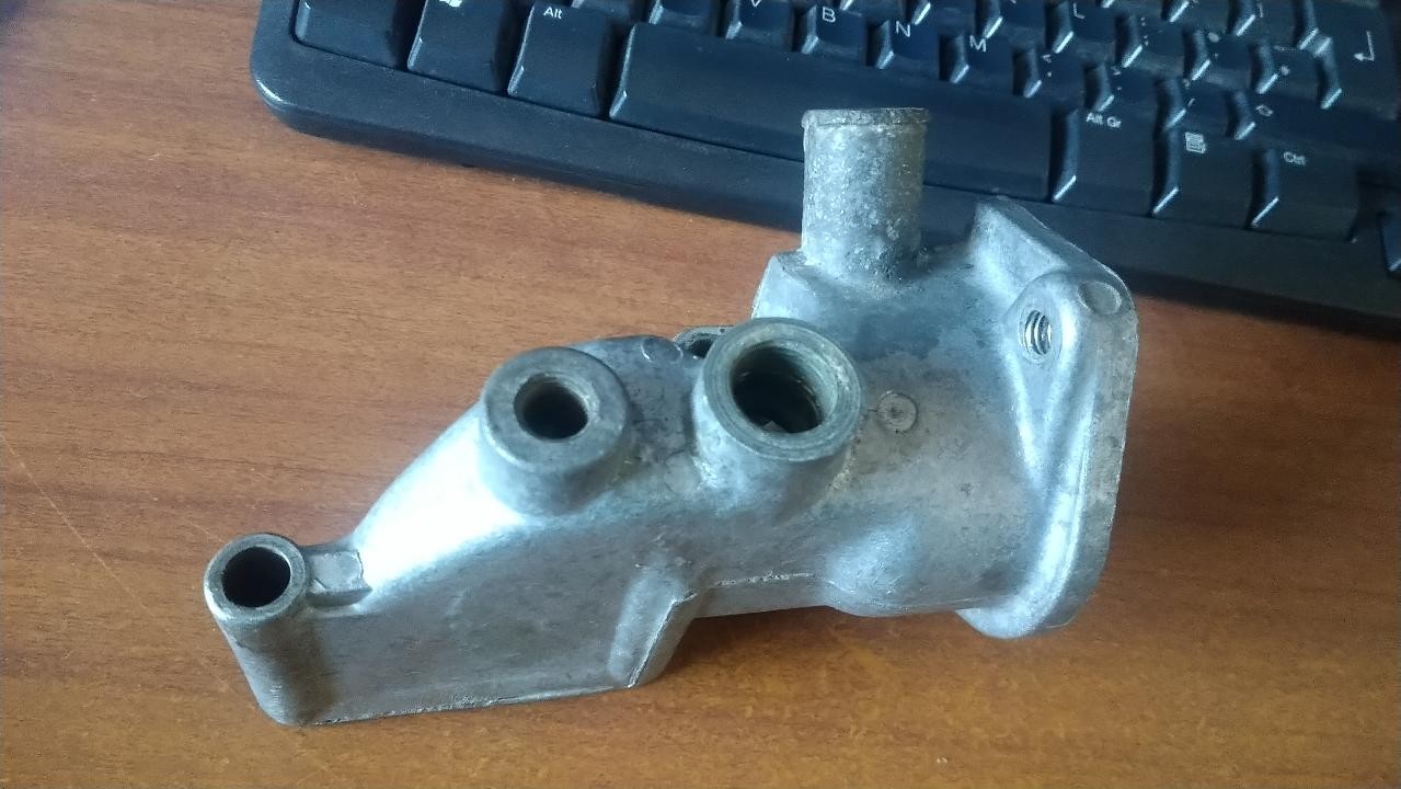

                              • Well more things for me to find that the 'engine company' lost. The lower sensor for the carb cooling fan. That was a challenge finding that part number. Some good things though as the little things matter, some rare part for the engine and a trial fit before adding the bolt washers and tightening to the first torque stage and added the new thermostat housing
