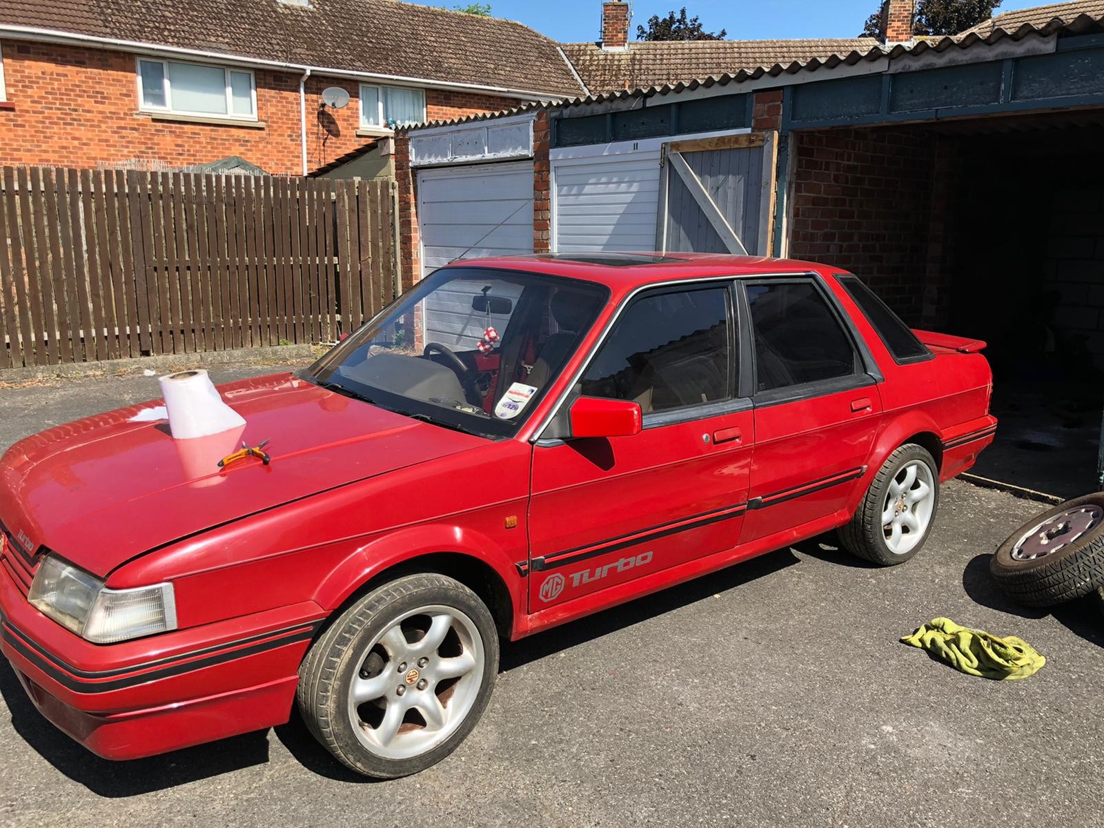

MG Montego Turbo goes
  • Cleaned up not too bad at all
    • Paint need claybarring but no rush for that
      • Brakes next

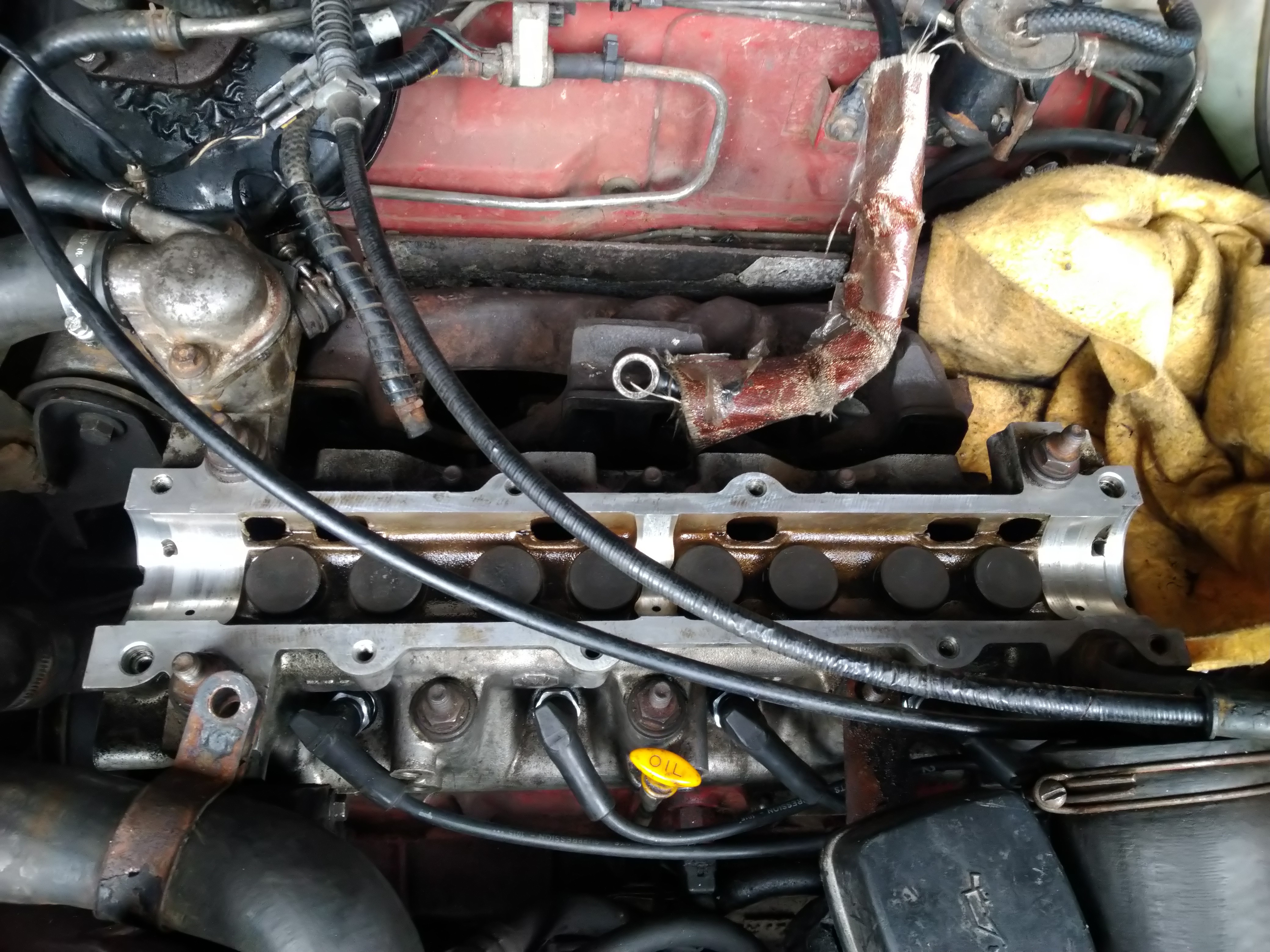

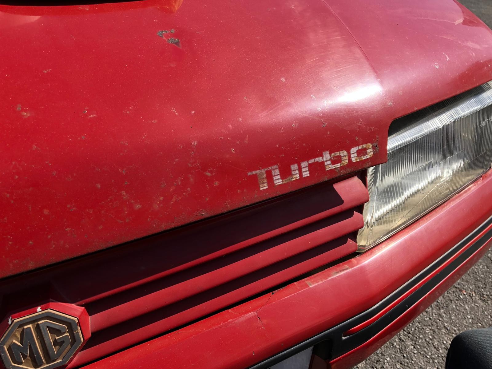

        • More done today, door and bonnet decals on, 3 door cards on, now has brakes, and we were going great guns. Unfortunately the car started to miss a bit so Chris removed the sparkplugs but one destroyed the threads on its way out, so that to sort, and will have to replace the exhaust downpipe as its a little too long so it's banging on the front subframe when the cars moving

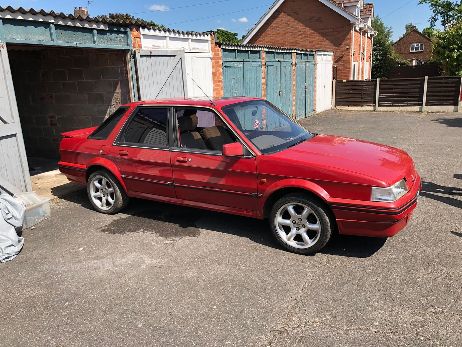

          • More, the car is beginning to look good now

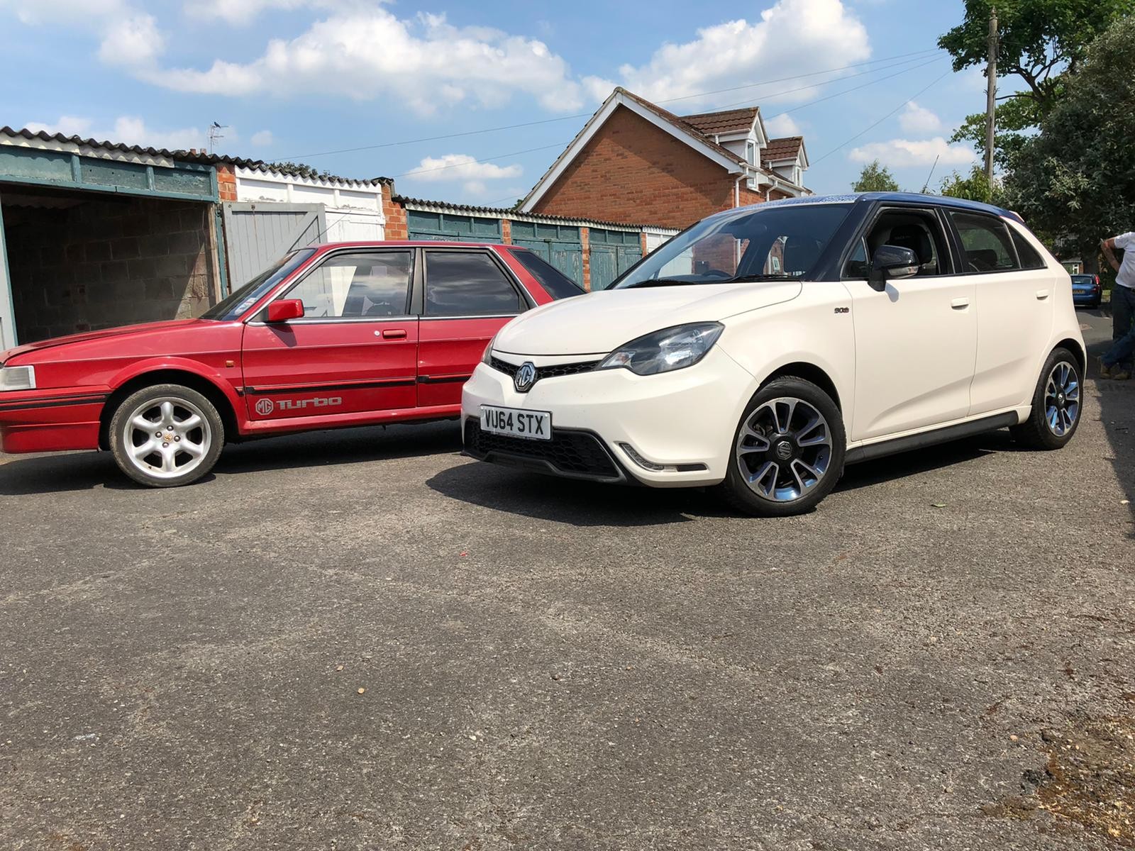

            • And against Chris's MG3

                • Spark plug problem now sorted, helicoiled, head on and now running. Good job we removed the head as it had a cheap 2 lt carb gasket on it and no thermostat. I reved the nuts out of it and the spark plug held firm so very pleased. Note to self, helicoil with the the head on in future then take it off. Oil change next and sort the hot start problem we now have that we didn't have before due to no thermostat

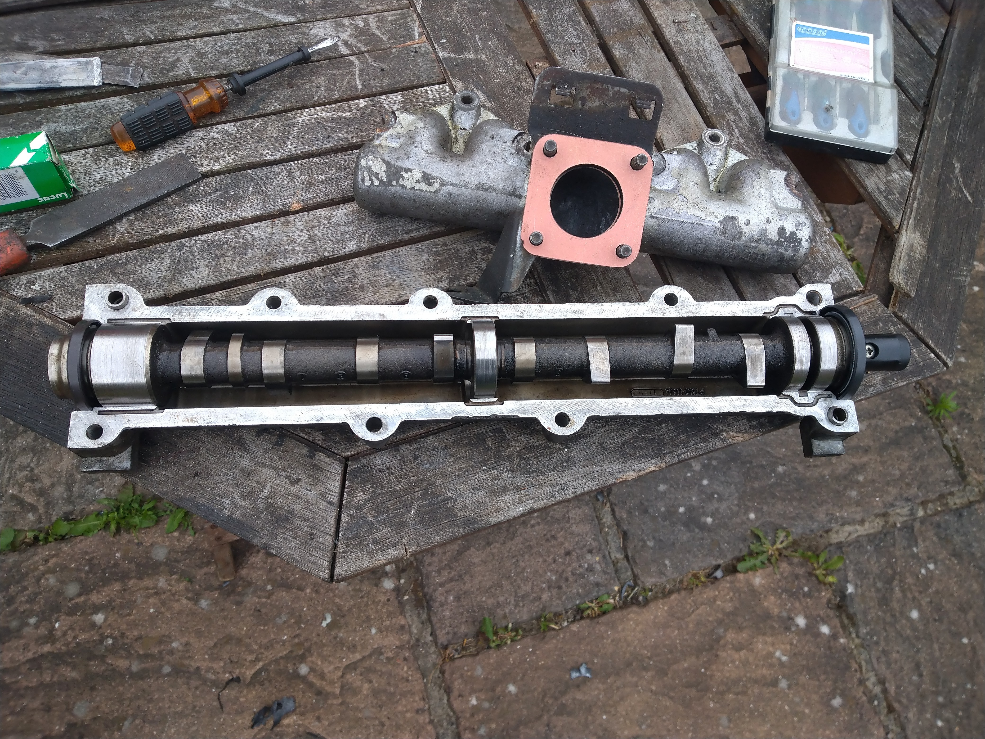

                            • Cam cover removed and both manifolds and the carb, Cover was leaking in the centre and I didn't touch that 5 years ago so will sort that. NOS Lucas rotor arm now on after I filed the shaft as it was too tight, also made up a screw to hold it in and put in new oil seals I have in my spares, Ive also replaced the carb gaskets as we didn't do that before because they looked ok but this time i'm making sure no more air leaks, also replaced the vent valve as that maybe faulty. Just waiting for the sealant to arrive next week
