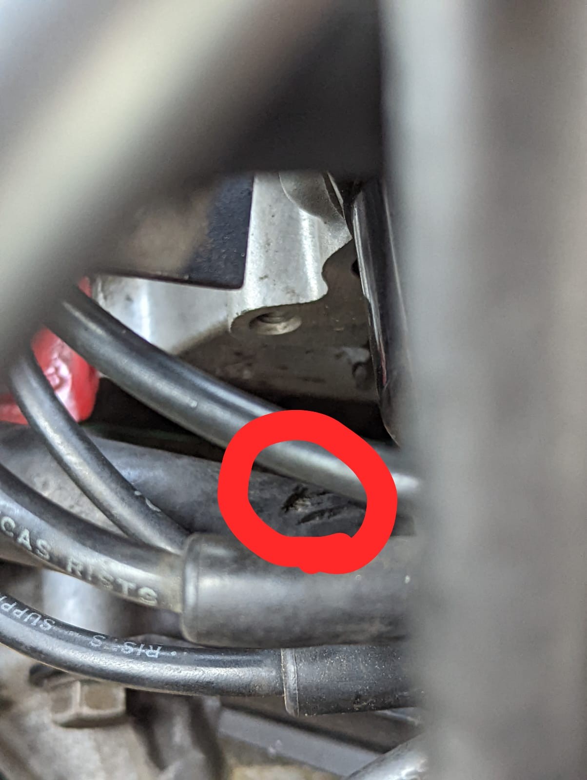

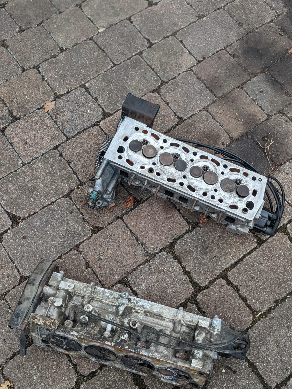

    • Well after 400 miles one of the water hoses sprang a pin hole leak and drained all of the water over a period on the A1 yesterday. The temperature gauge didn't move over half from its usual quarter and it looks as though the engine is knackered. Didn't notice anything till a loss of power. Headgasket has definitely gone with overheating and I'm worried about the block as the amount of water pooring out of the exhaust when turning it over and its not making the usual sound when turning over. With luck it's just the head gasket but I fear the worst with a crack somewhere in the block. Not Chris's fault as these things happen, to say he's a bit pissed off is an understatement. The car is back on my drive to I will have a proper look later today.

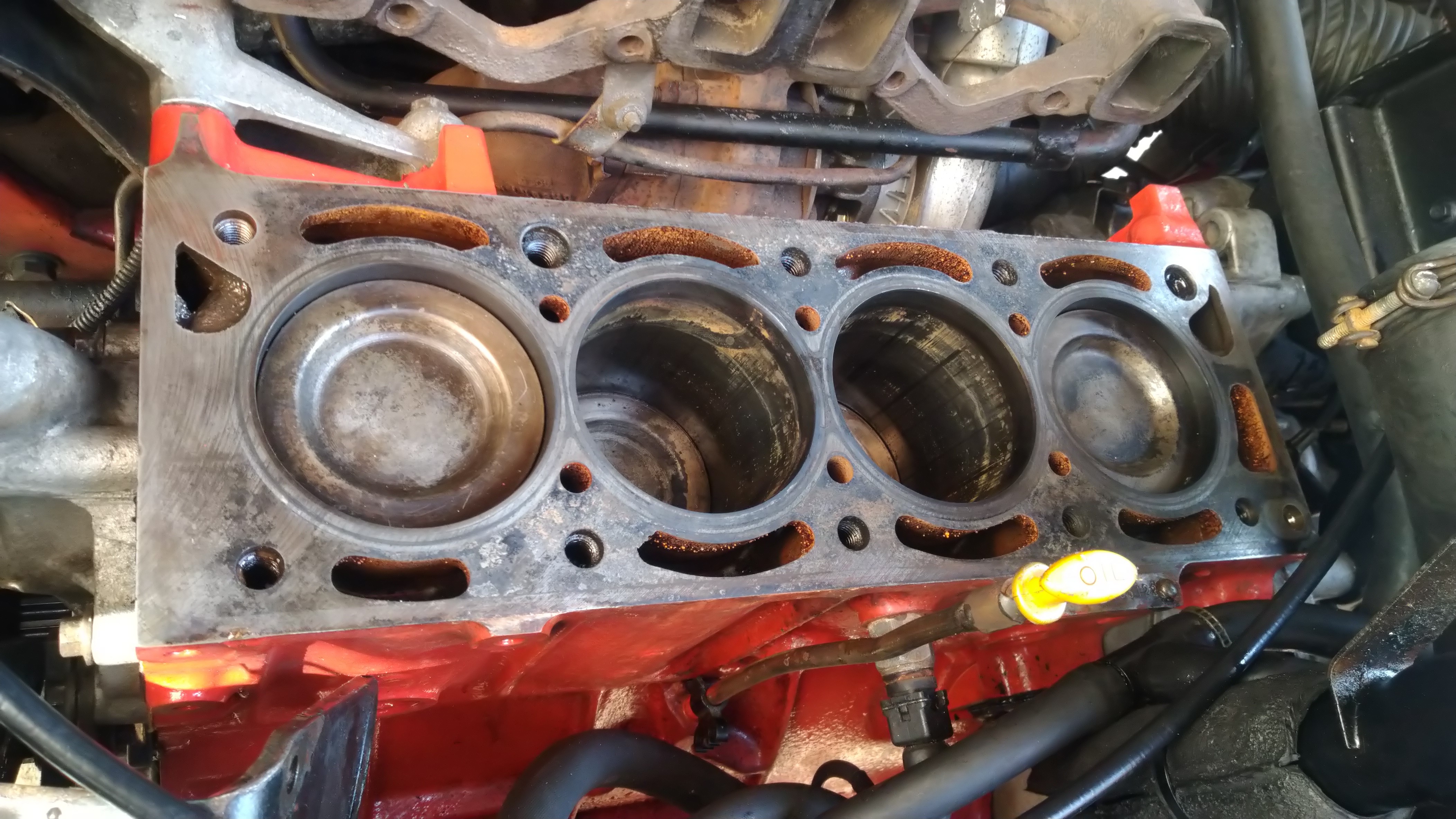

      • What a lucky lucky boy. No damage except the head gasket, and the small pin hole causing the trouble

            No I don't but I can put a joint there. Would have been a pain in the arse taking the engine out again and finding new parts so very lucky no damage. One thing I noticed cleaning the head is there are now groves in it where the gases have escaped in between the bores and and round the edges of the bores where the headgasket has been so have to think that's now knackered

              Has the head been planed before? it might be salvageable (depending how deep grooves are) I vaguely remember that you can take about 15 thou off ..
                Yeah been done before and the groves are deep between the bores so would probably need welding then skimming. I do have another head so will rebuild that and Chris is coming over on Saturday so I can teach him. I've also called on a good friend for a replacement head and manifold gasket as I've run out. So in all it'll cost nothing but time so more luck there

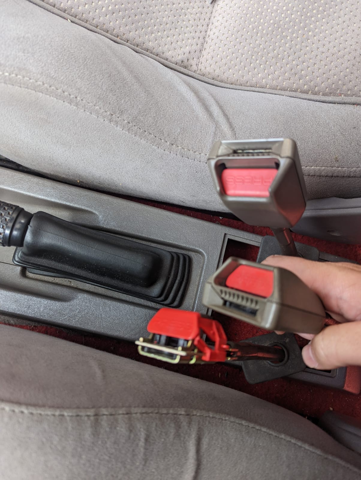

                        • Got a bit done yesterday and the replacement head and gaskets turned up. Also fixed the hrw and seatbelt stalk that collapsed

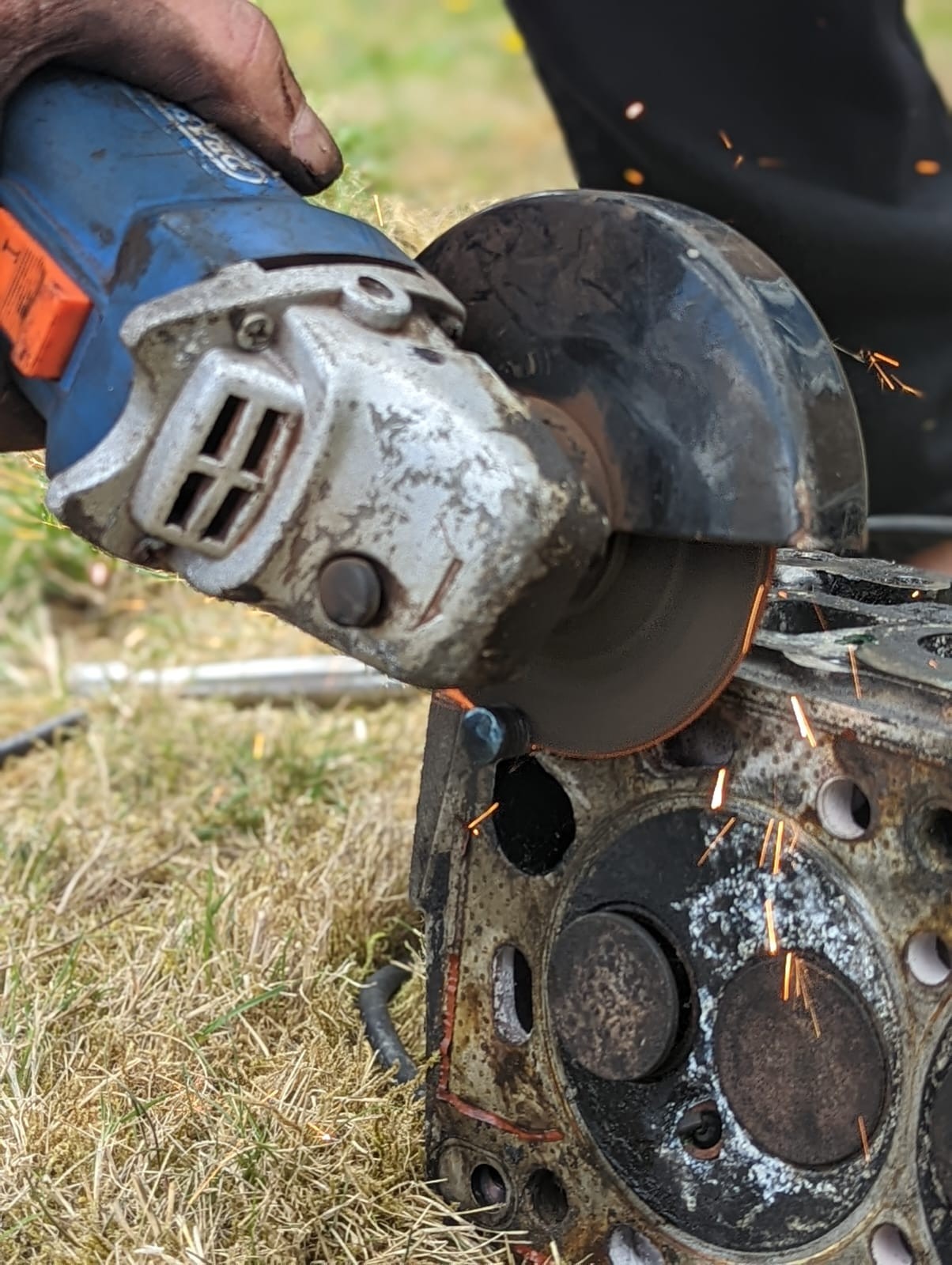

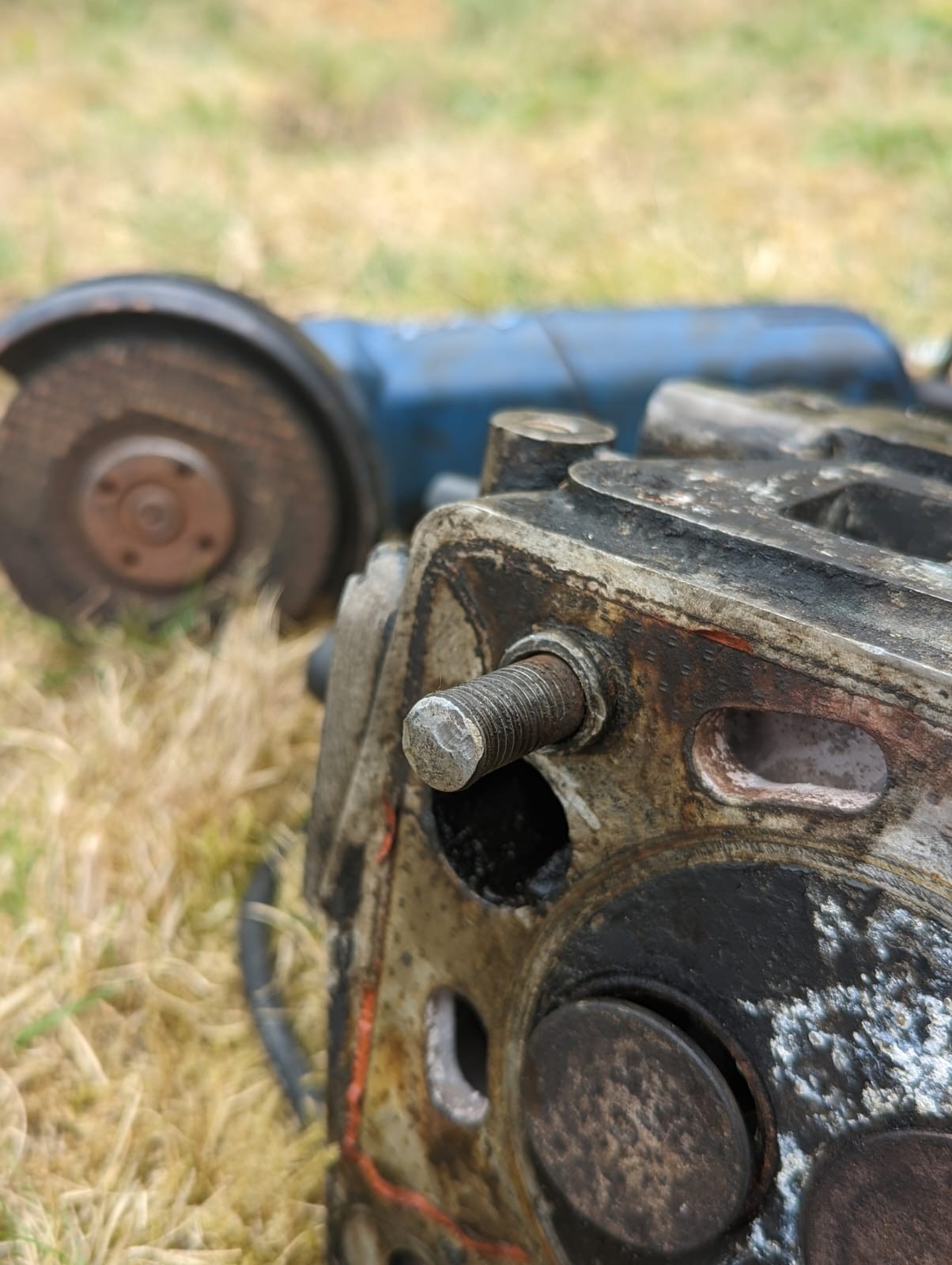

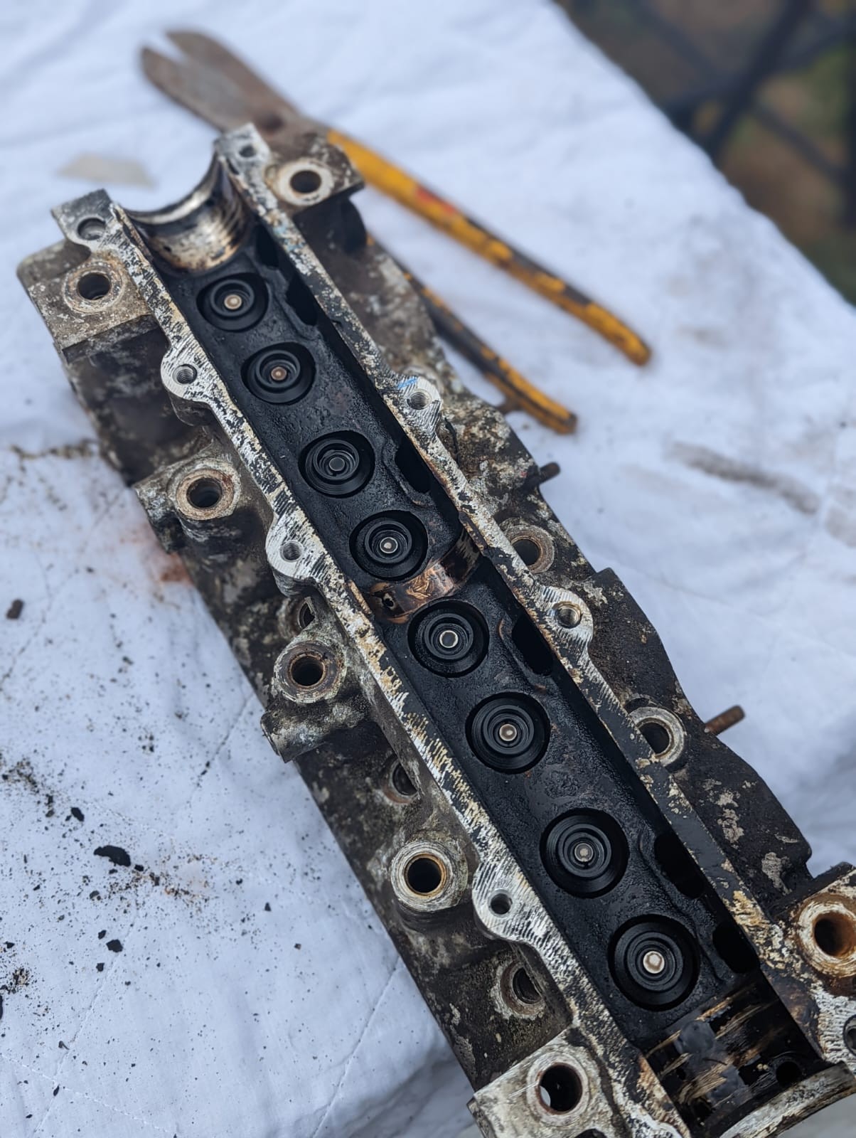

                          • Took over an hour to get this headbolt out as it was rusted in, had to cut off the bottom and gradually move round and round and smack it with a hammer and drift and go again with plenty of plus gas. All stripped now and just one manifold bolt to drill and re tap as that came broken in the head. Pics don't show the full strip down. Will clean it next and go from there
                            • I know the feeling..the pictures don't show the full nightmare, but always nice when they surrender! Should be back on the road fairly soon I guess
                                Not sure about soon and it was satisfying that I finally got it out. I have new stem seals on their way and in hindsight shouldn't have sold the last ones I had, carb cleaner should clean up the filthy head of old oil, will also clean up the valves etc but they look good. But I only have a few days this week then I'm away for a jolly at twinwoods 1940s weekend for my Mrs 60th birthday then off to France on the 4th September for awhile, so maybe it'll be finished late September
