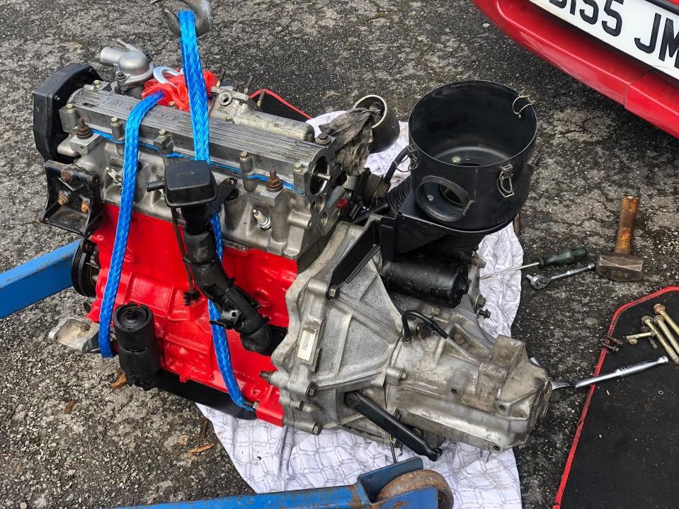

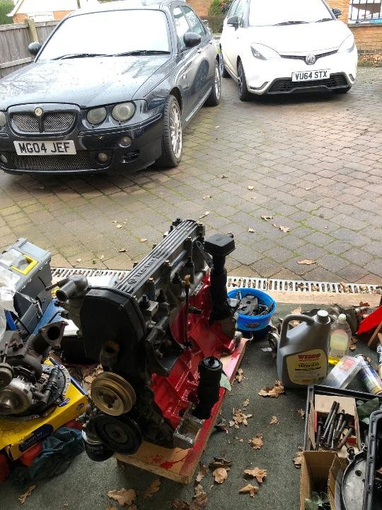

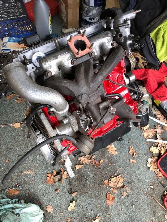

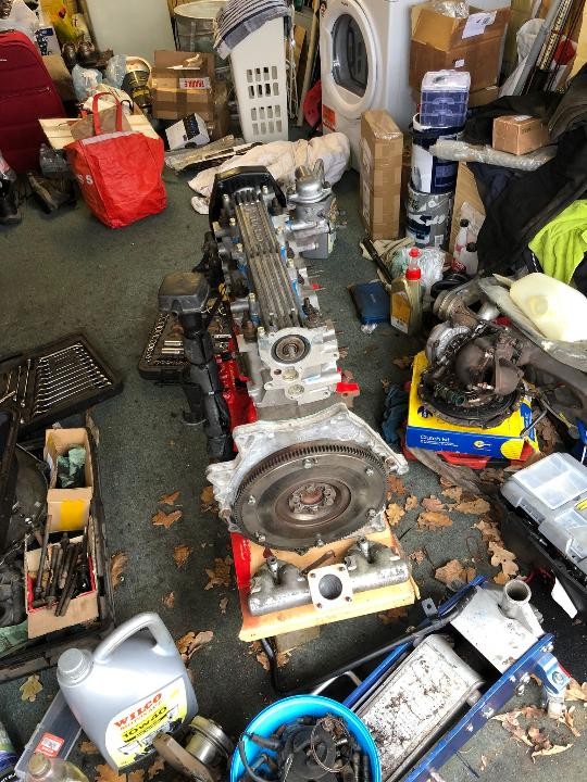

  • Both my son and i were not working at the weekend so next parts on the car. Saturday was putting the last part on the engine etc for transportation to the garage. Head on, manifolds on, oill return on and (not shown )the head shield for it

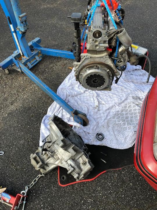

    • More, priming the oil pump and turbo once attached, clutch on

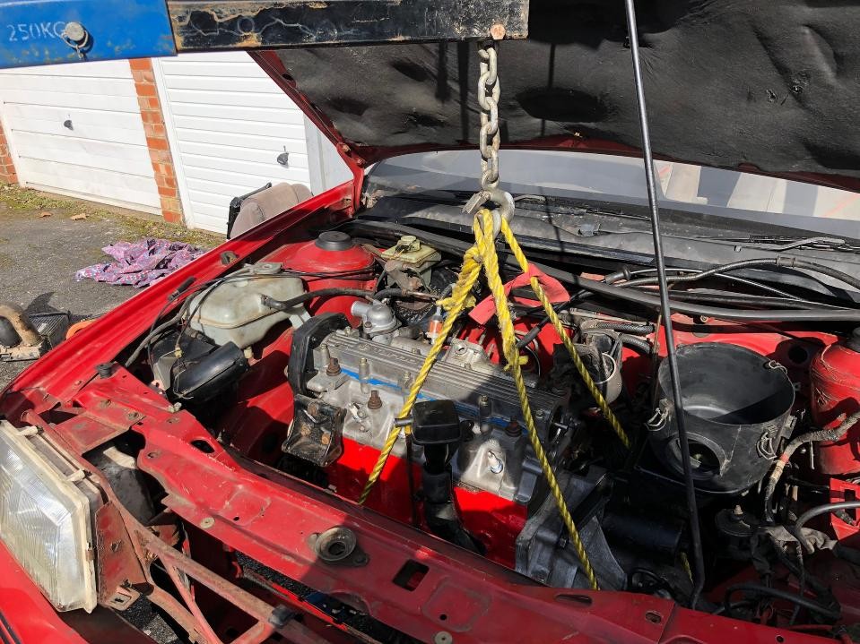

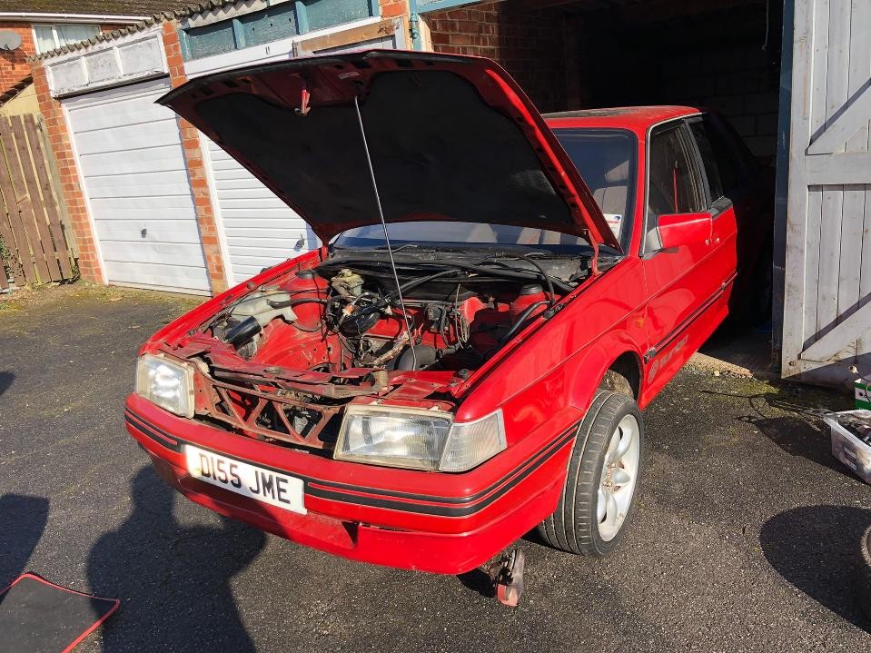

      • Sundays jobs, engine was a little heavy for us to put in Chris's car so picked up my engine hoist, pulled the car out and not moved since the engine bay clean in July last year

        • Then the gearbox attached, up and in the engine bay
          • In it goes

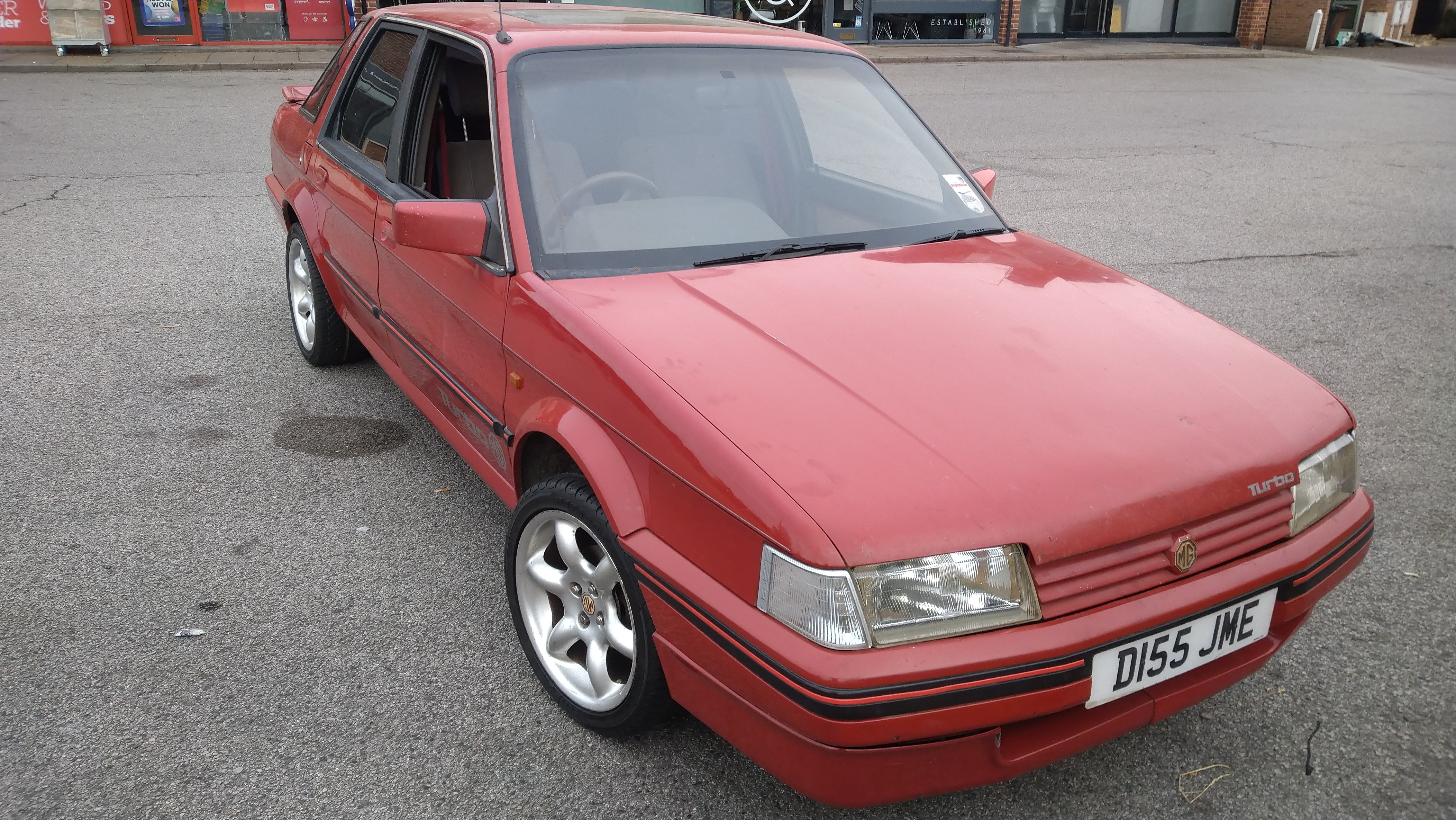

                  • Getting near to mot time now. Car started easily and moved out of the garage. Hand brake sorted, lowered the tickover, sunroof now working again. Checked all for its mot on Tuesday and all is working. Chris took the car up the road and it runs very well now, bit ticky on two valves so that to look at at a later date as will be a couple of other things after a few months driving. Namely the power steering pump that isn't working properly but will see what happens Tuesday first
                    • Mot day

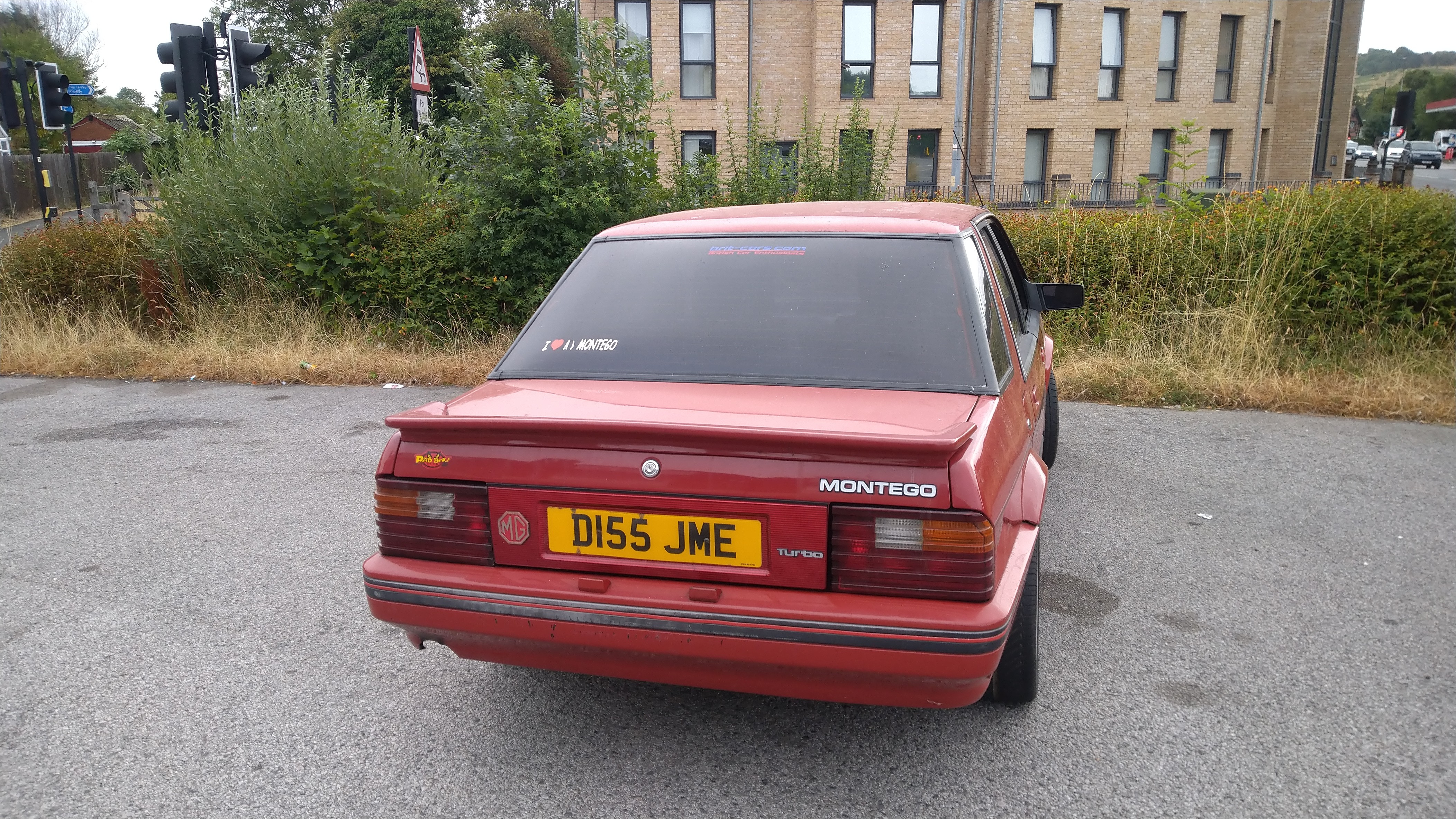

                          Thanks, passed and we'll chuffed. Struggled on emissions at the start. Supposed to be 3.5 max and was 10 at one point. But after a little adjustment and letting the car get warm it got much better. Chris will be picking it up later to drive it to sheffield and use it for a bit for a shakedown. Will be changing the oil etc after 500 miles and see what things come up. He's very very excited
                          • All insured and agreed value of £10,000 now done
                            Well the snagging list has started, HRW stopped working, power steering I know about, fuel gauge only shows 3/4 when full, speedo is clicking at 50 mph, exhaust need to be moved a bit and a tail pipe added or stainless made up with a tail pipe. Expecting a few things in the next two weeks as it needs a shakedown to iron out various things. Engine pulls well and the turbo is whirring up nicely though and easy gear change. He's getting lots of thumbs up driving to Sheffield so can't be bad. These are cool cars now apparently to the younger generation
