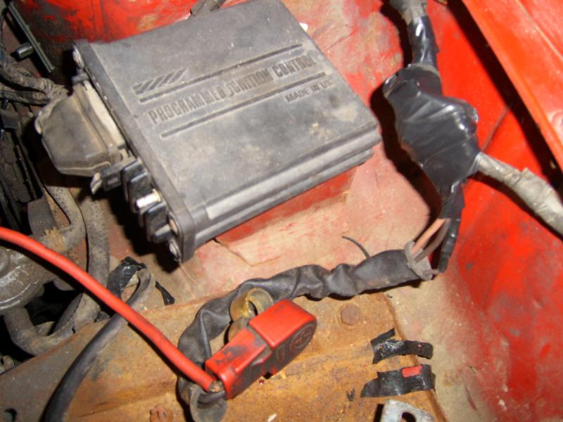

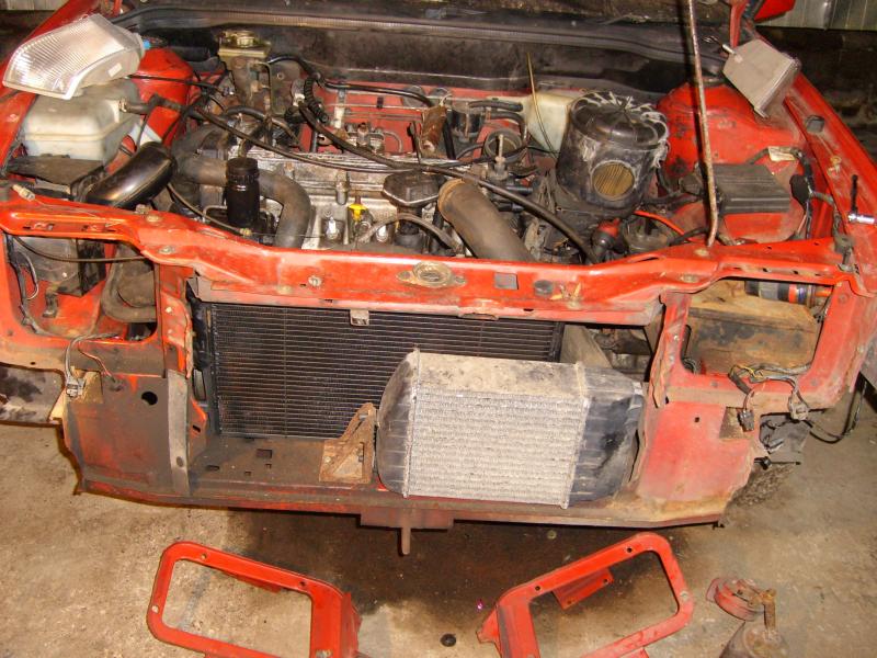

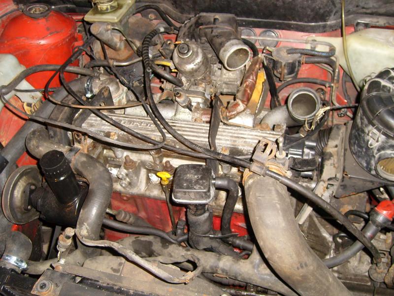

                            Finally got some time to donate to the car today and very slow progress today.
                            Curse of Andy I think, well I was cursing him,
                            Hadn't noticed before but the front panel centre had been cut off, so the front bumper had to come off, ALL bolts were siezed solid.
                            Then trying to remove the exhaust two studs snapped while undoing them, so the exhaust flange on the turbo had to come off.
                            I've lost one of the boost pipes, so didn't get that finished
                            • #44

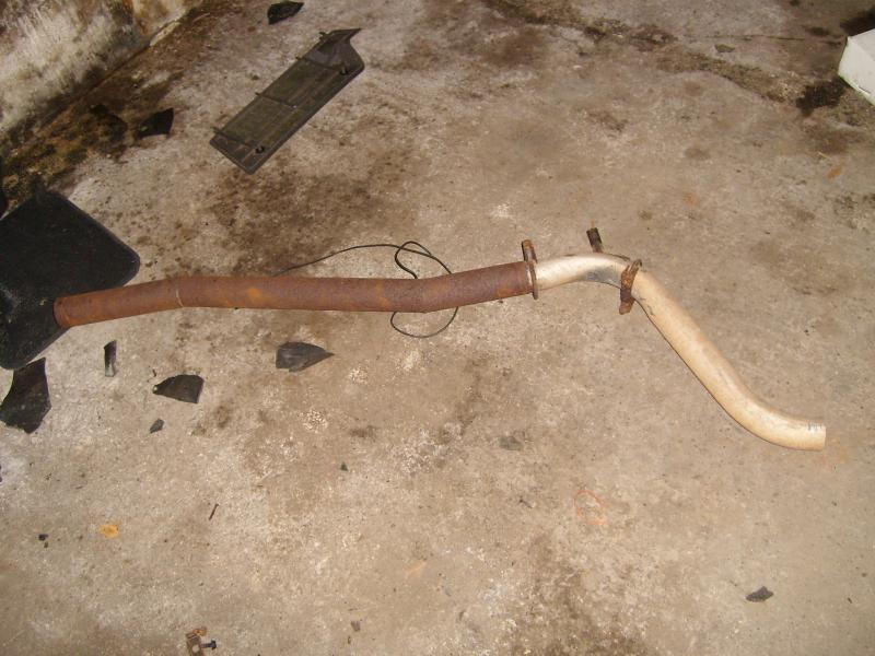

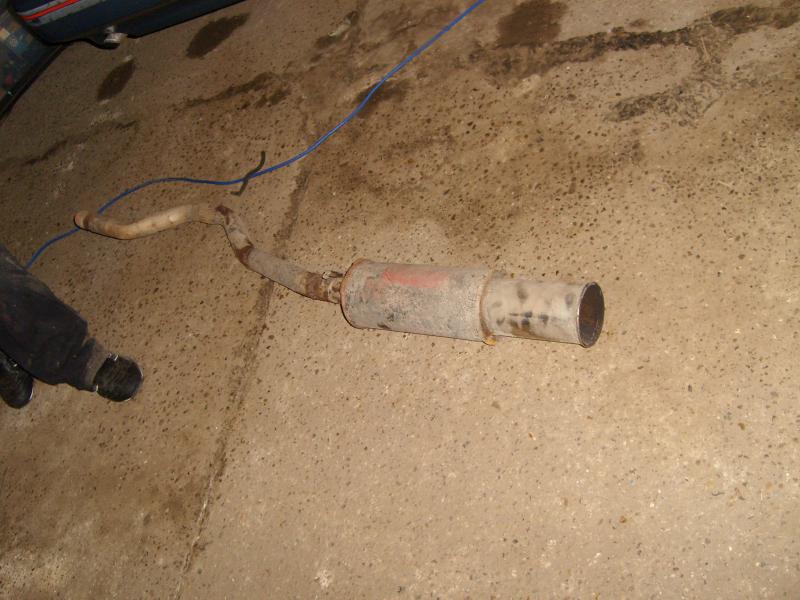

                              Down pipe is shot, no middle box and a bigbore back box. It's in good condition Rick if you still want it.
                              Throttle cable had been cut, no idea why. so I have replaced that
                              I had bought a long length of petrol pipe to replace the petrol tank pipes as they aren't up to scatch, and couldn't find it, so that didn't get done, on the plus side all of the re-wiring to the tank is now done.
                              Slam panel is on, and various other parts today.
                              I have to get back to the barn soon as various parts that are needed are still there.
