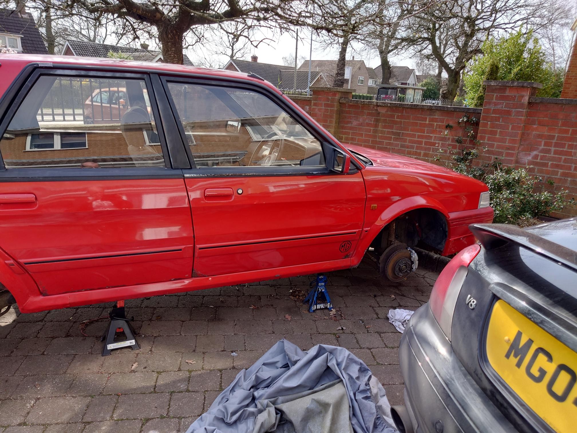

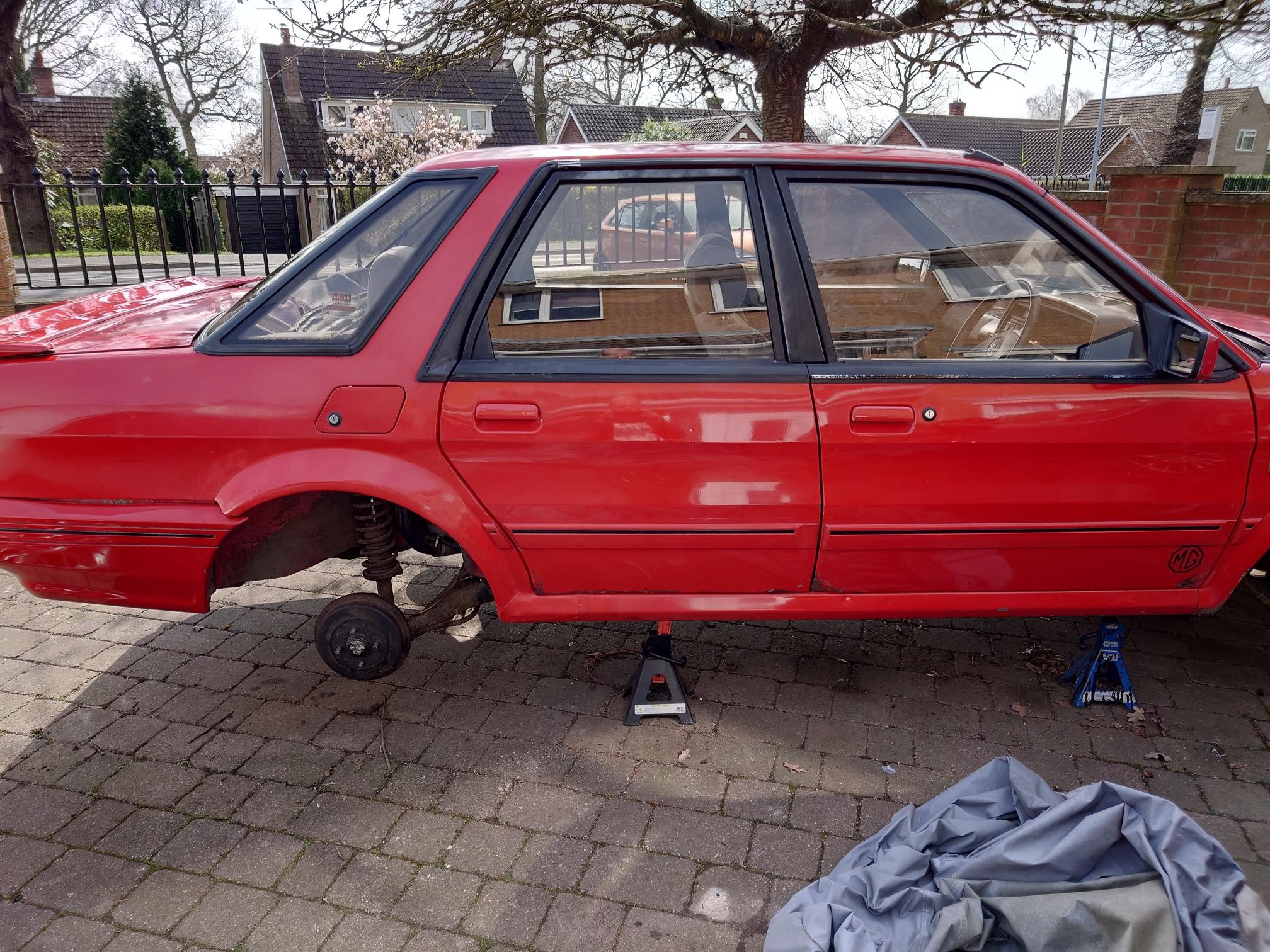

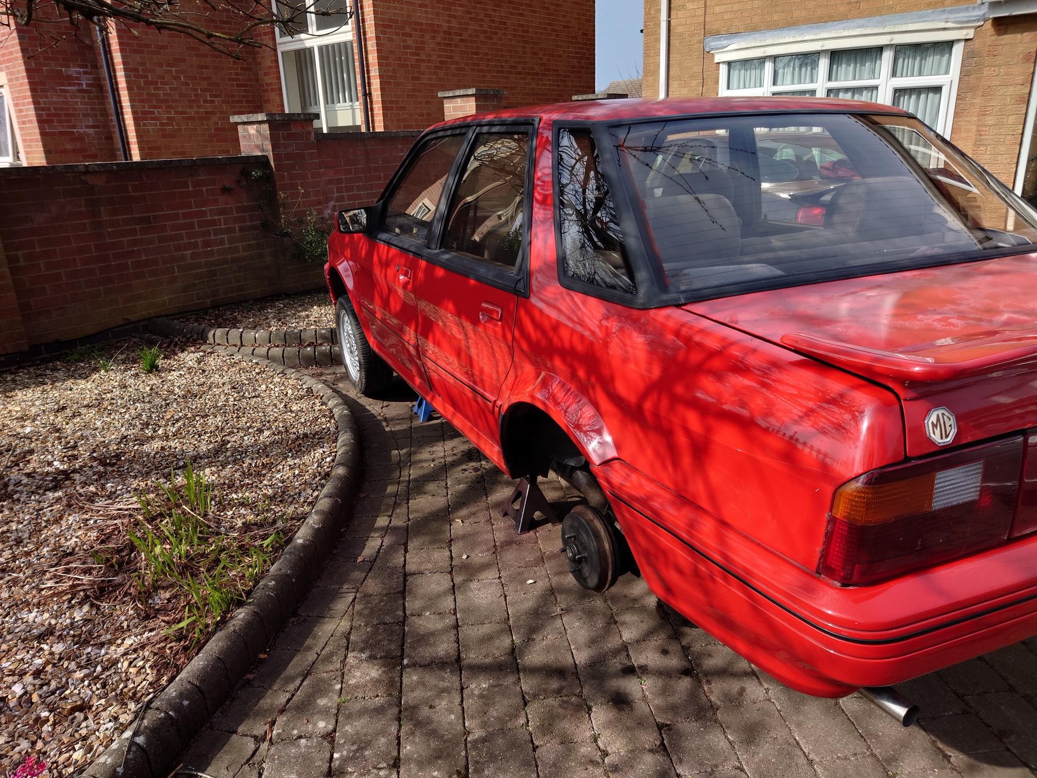

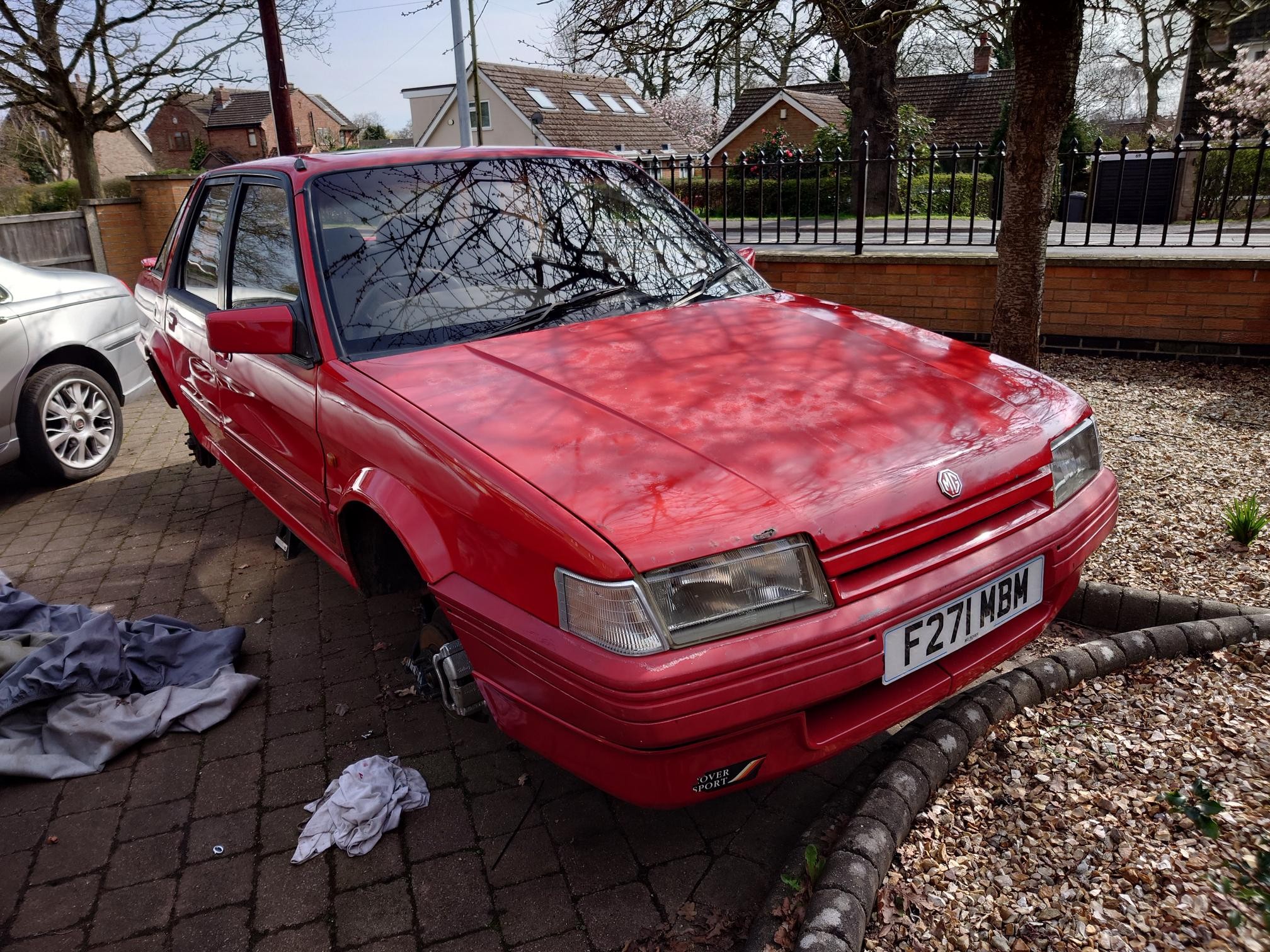

Sorting the clips on the fuel pipe under the car and the pipe sprang a leak. Buggar so ordered a fuel pipe. So got polishing
MG Montego efi
New fuel pipe done, washers all cleaned out as they were blocked. Other than a battery clamp which I have somewhere in what's left of my spares the car is now ready to go for an MOT. Stinks of stale fuel but with luck 2 gallons of super unleaded on the MOT day should help with the emissionsLast edited by Jeff Turbo; 27th March 2026, 09:25.1958 Ford Consul Convertible. I love this car
