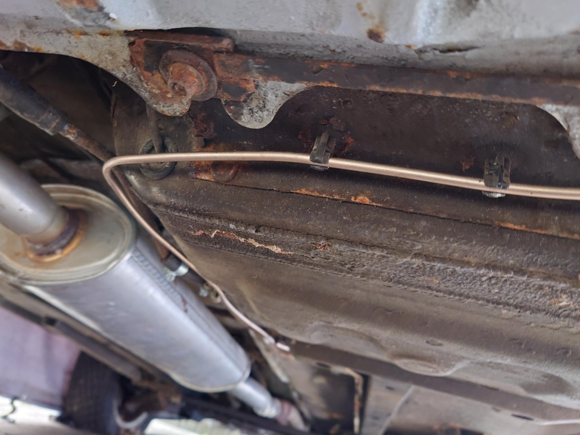

    Started the car up and testing the brakes as the rear pipes look a bit crusty and the rear offside pipe burst so I will change all those

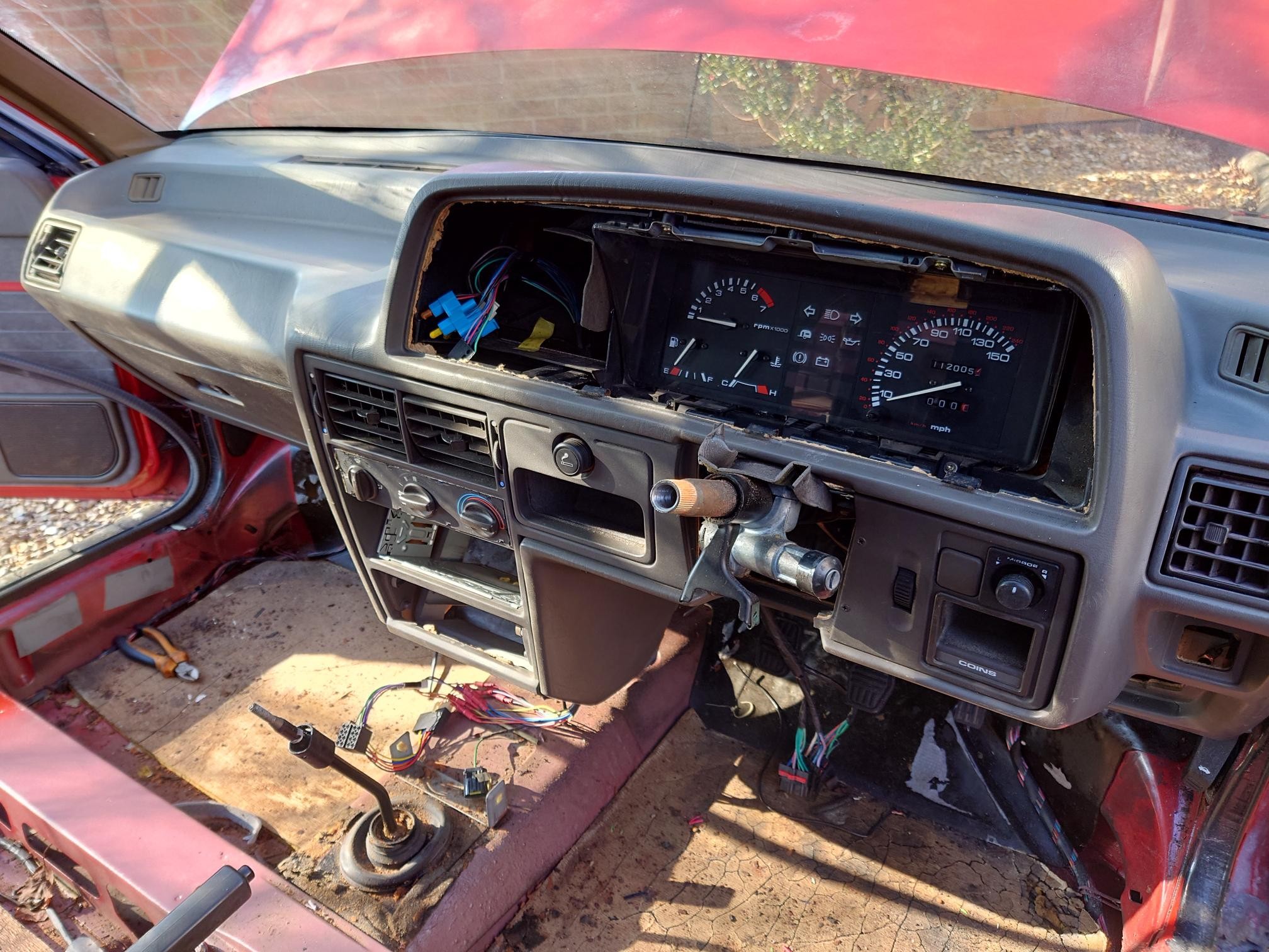

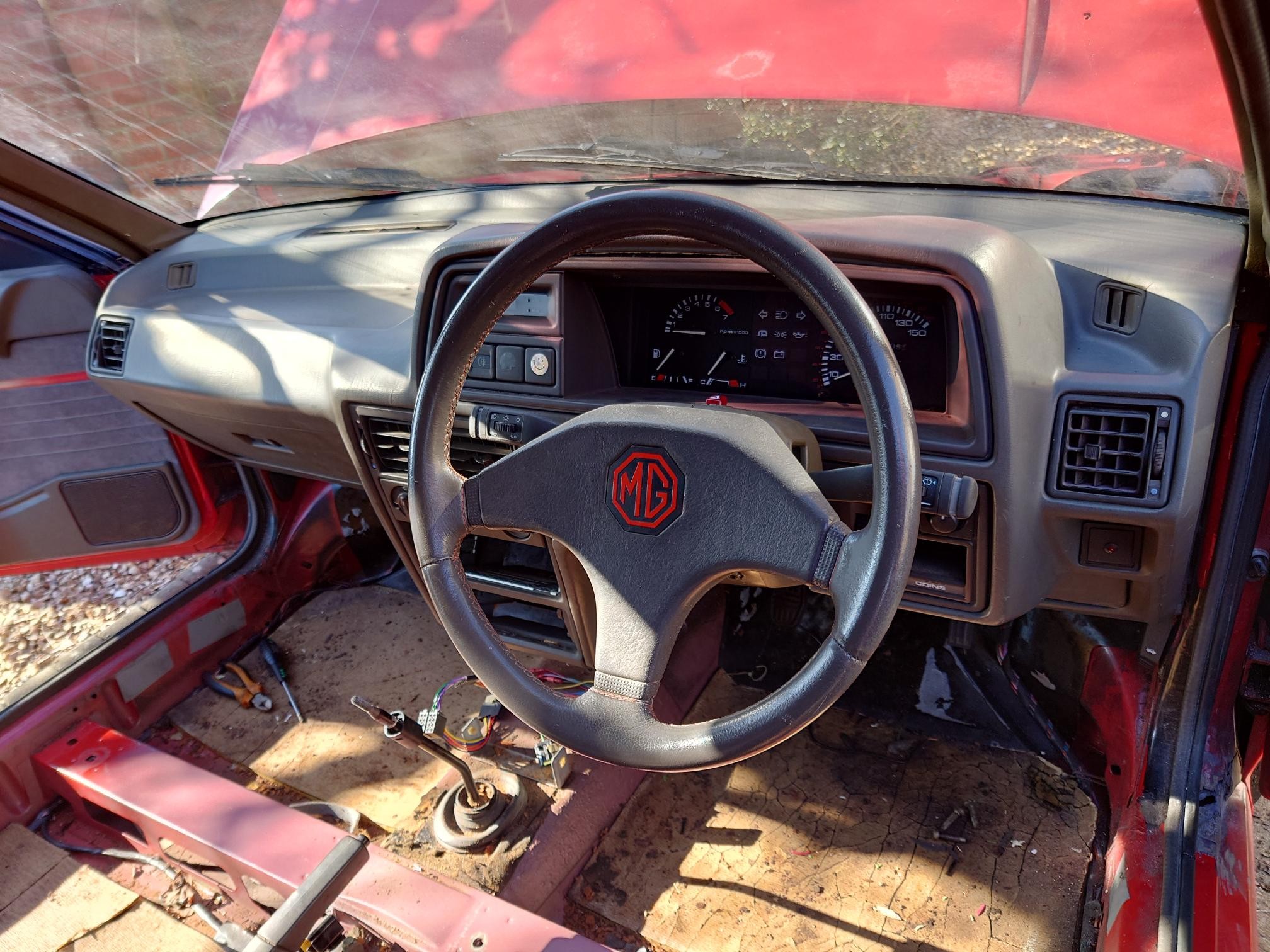

          so I put the dash back in and took it out on that. Also put the drivers seat back in or I can't pump the brakes properly when I need to

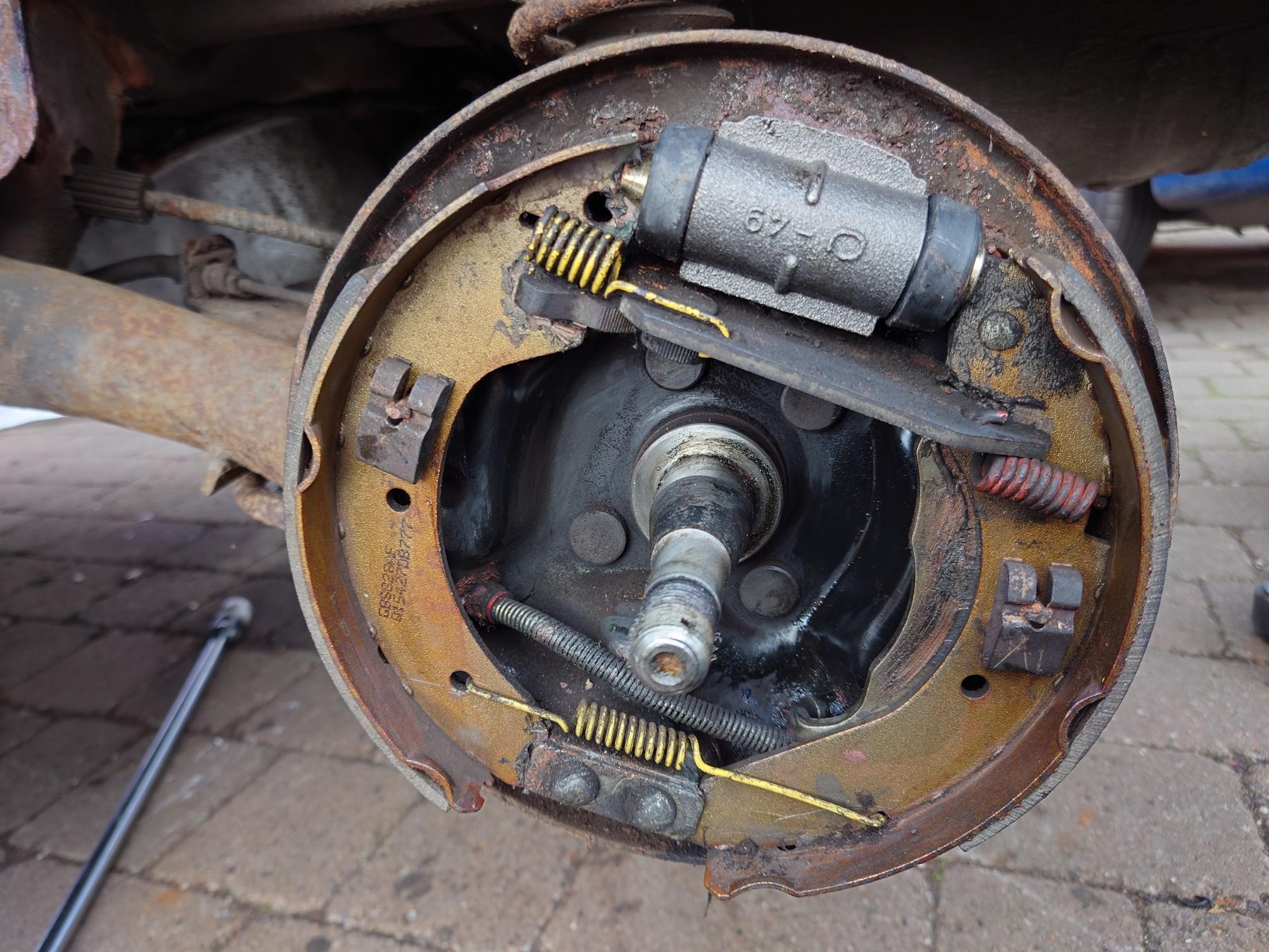

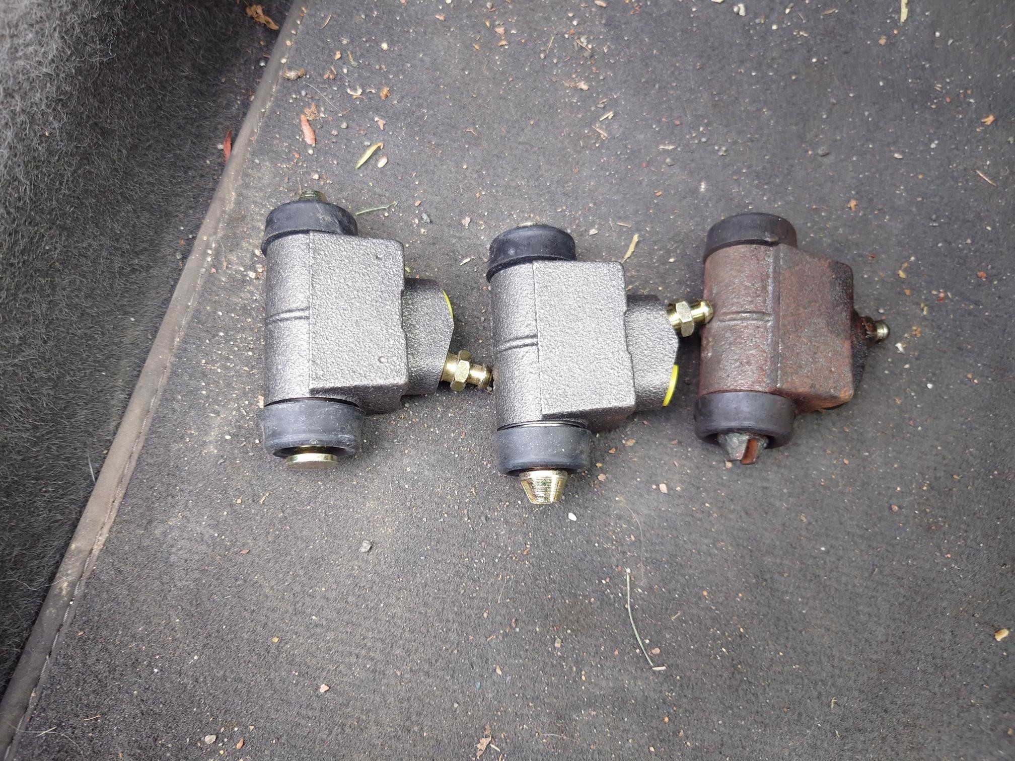

            Brakes finally sorted today, offside brake pipes replaced and both rear wheel cylinders as both were knackered so I replaced both from my spares. Now have brakes again so happy days

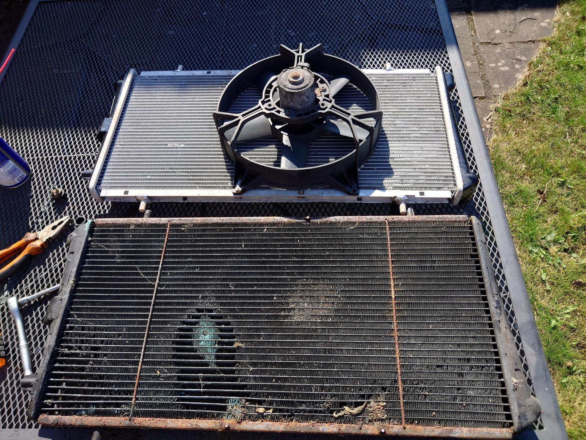

                Had a couple of hours spare today to continue with the car. Replaced the temp sensor but no difference so replaced the throttle body with one I bought off Chris as I was convinced the one on the car had some sort of fault due to the poor starting and the car starts on the button each time now. So that's done once and for all, well hopefully as the car has had many problems

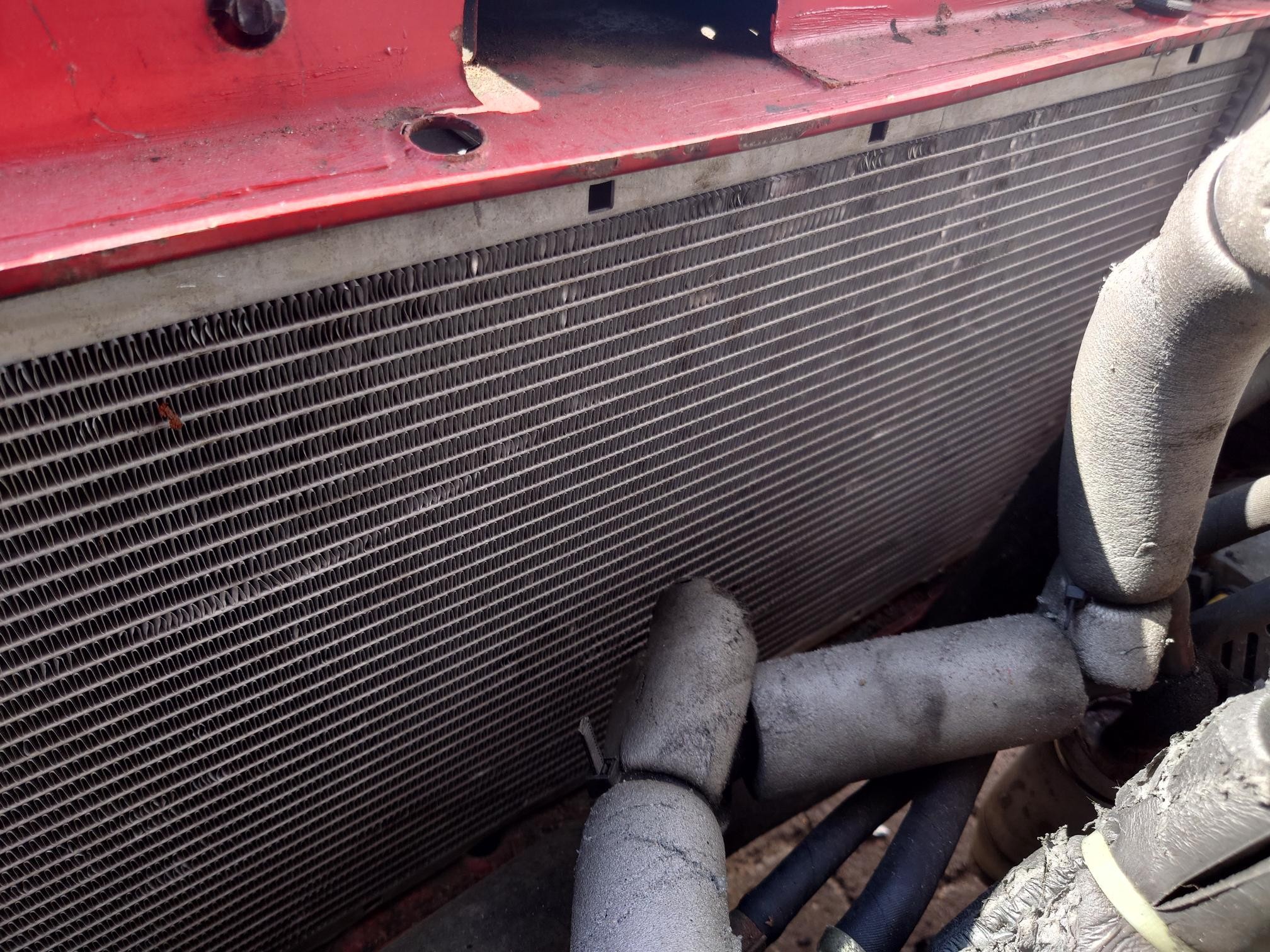

                Next was to replace the rad with the MGF one I bought for it as the temperature gauge goes up too quickly, the old rad was blocked so hopefully I've sorted that once I replace the thermostat, I'm sure I've already done that when I did the head gasket but it was a long time ago now so couldn't remember

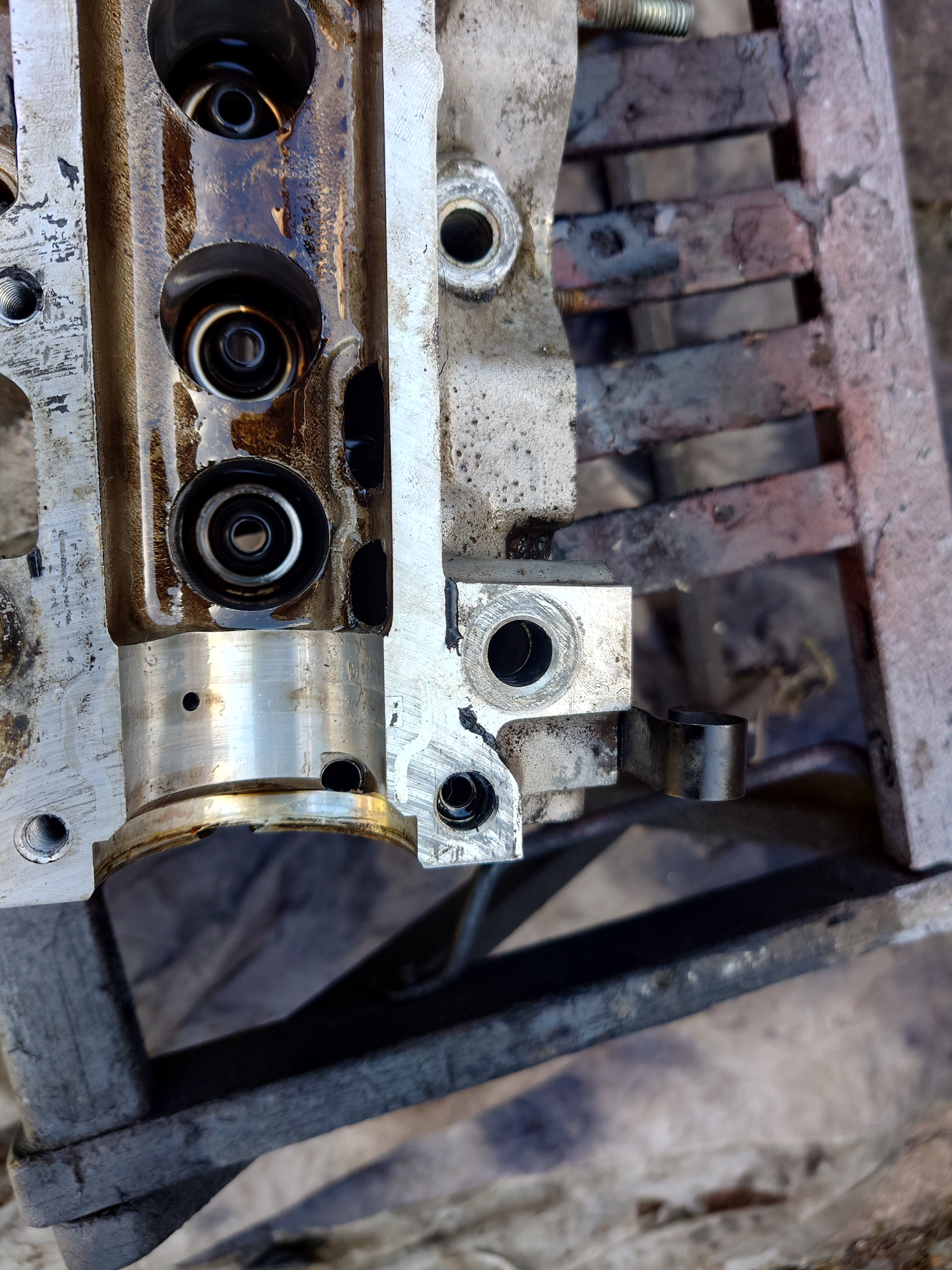

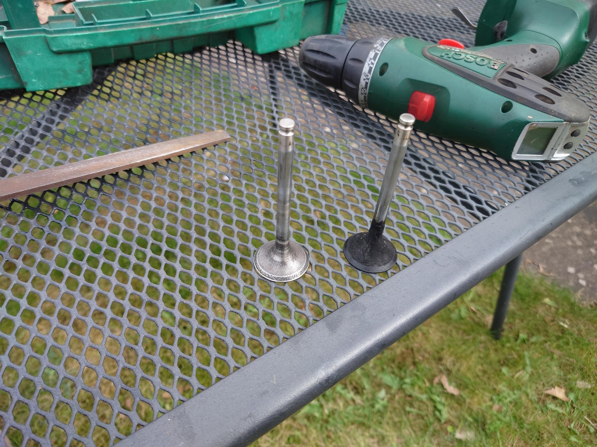

                            The issue is on this bore, it's clean with no soot at all as is the head with no compression also on that bore. The others are between 110 and 115 but this one is 20,so I removed the head and stripped it down to be skimmed. I will also change the stem seals as I have plenty of those and clean up the valves. I will also clean out all the injectors with my cleaner.
                            I'm not too sure why this is happening to be honest and has anyone got any ideas?
                            Can only be either the head not sealed, something wrong with the valves, maybe a bent one as the cam belt was a few teeth out when we got the car, or a piston ring but I would have thought if it was a ring all would be covered in oil unless it's a compression ring?
                            I left the coolant in all the bores and nothing leaked down then moved all to the top and not a lot of movement in the pistons so I'm running out of ideas

                              If you take the cam off to close all the valves (or turn it put suspect valves closed) then put some diesel or degreaser into the ports you should see if it dribbles out of a dodgy valve. I guess water would do the job if you want less mess, but water generally doesn't find its way out as well as diesel/gunk. I'm guessing that there is no sign of naughtyness in the bore?
                              • #90
                                Bores look ok to me but will have another closer look later in the week when I get the chance.

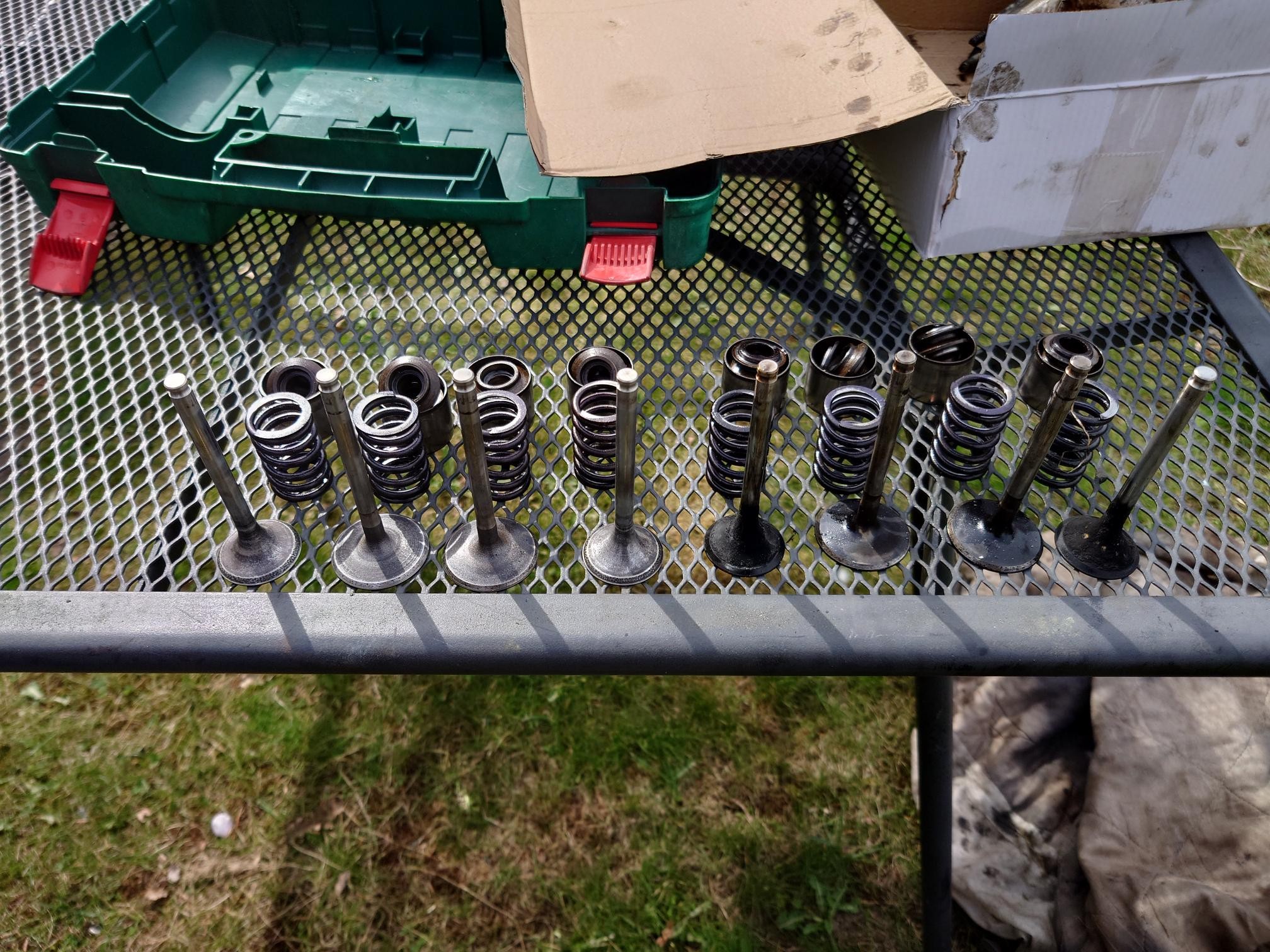

                                I've cleaned up all the valves etc and found the head gasket set I had left including new stem seals so after I've dropped the head off I can look more at the bores, they didn't look scored or anything but will get time later in the week
