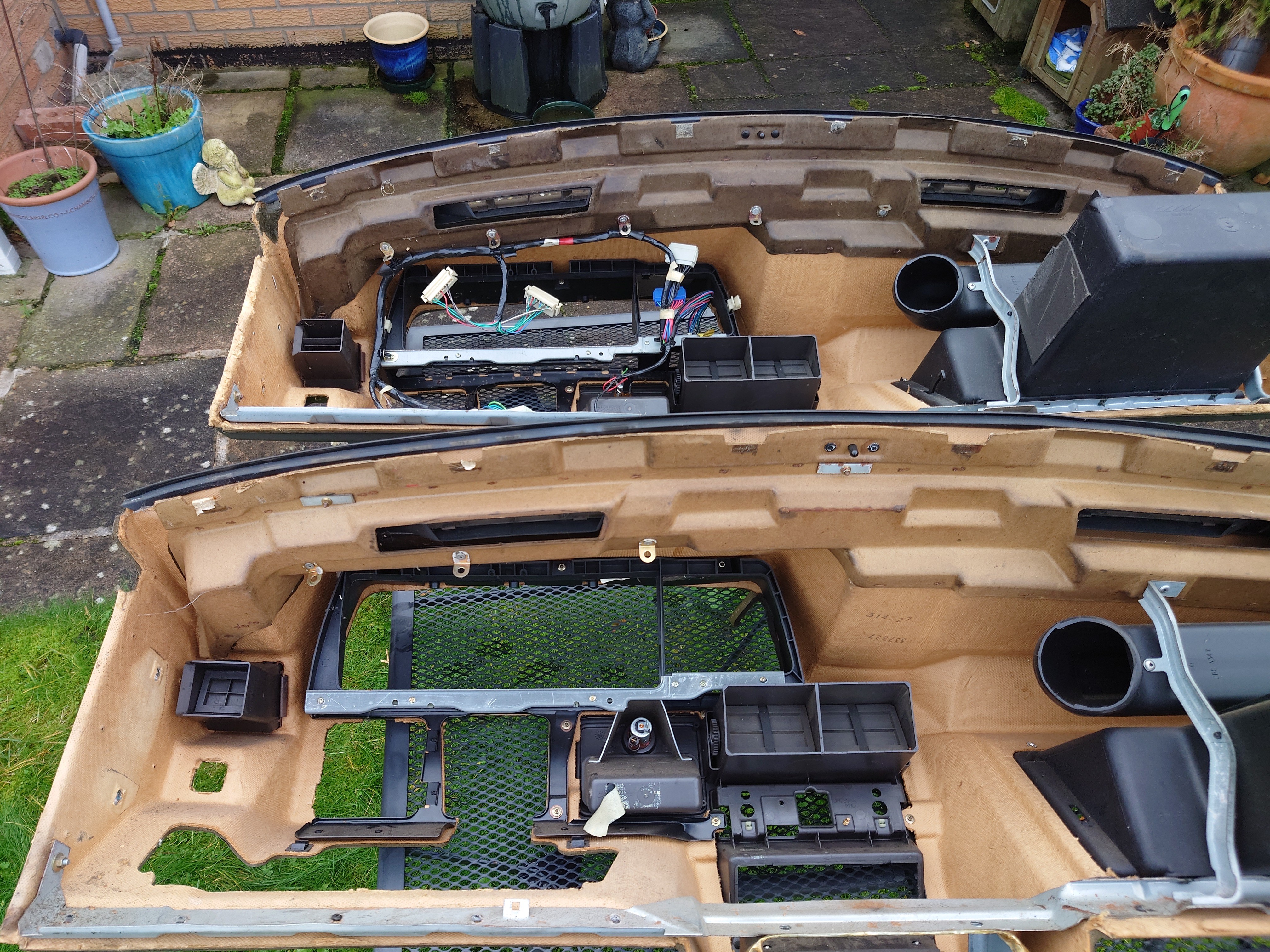

        • #64
          More done today, swapped over wiring etc and cleaned the dash up
          • #65

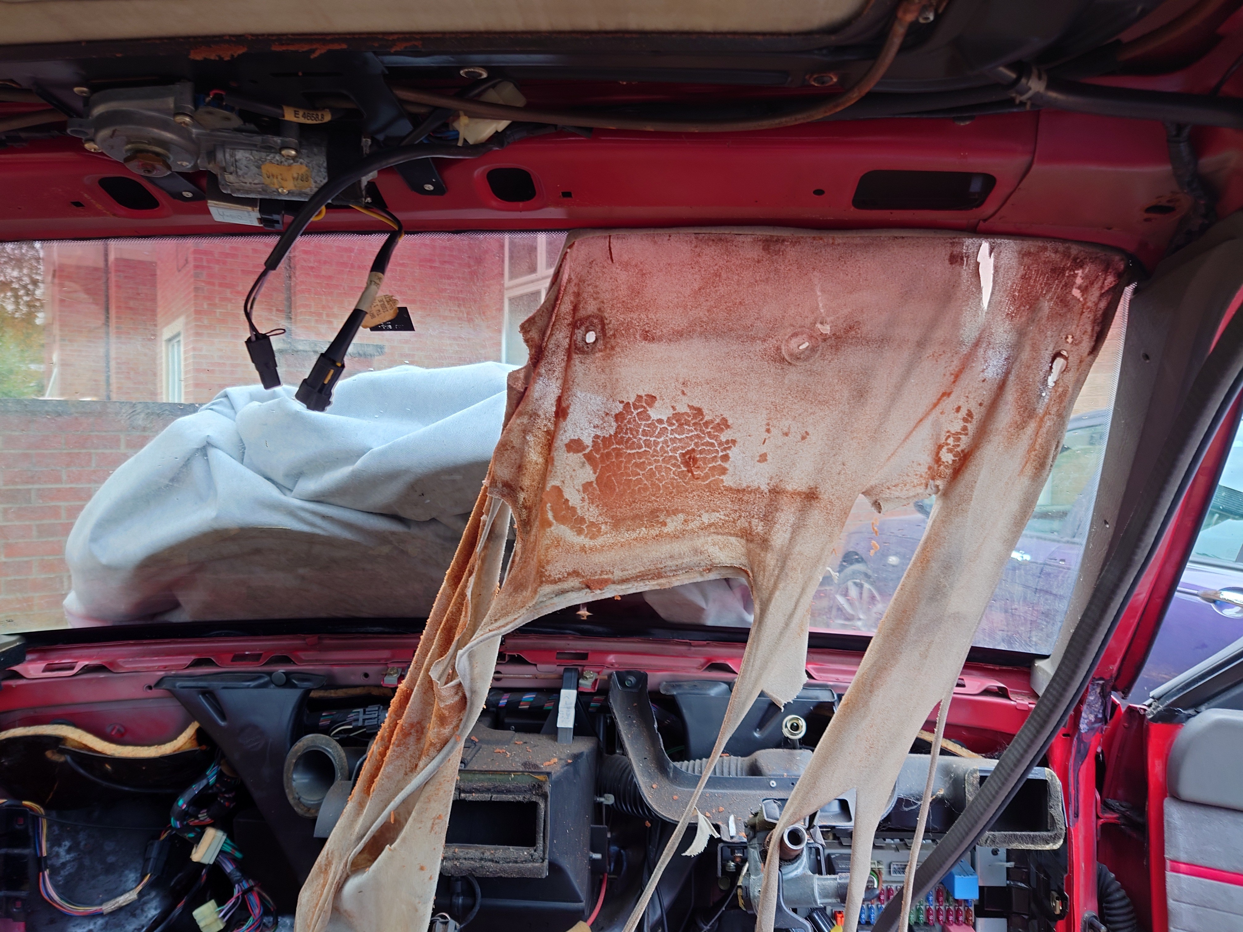

            Then took out the headliner, windscreen had been replaced in the past as some of it was stuck to the screen .While it's out I will check on the sunroof motor as it's not working and also replace the glass

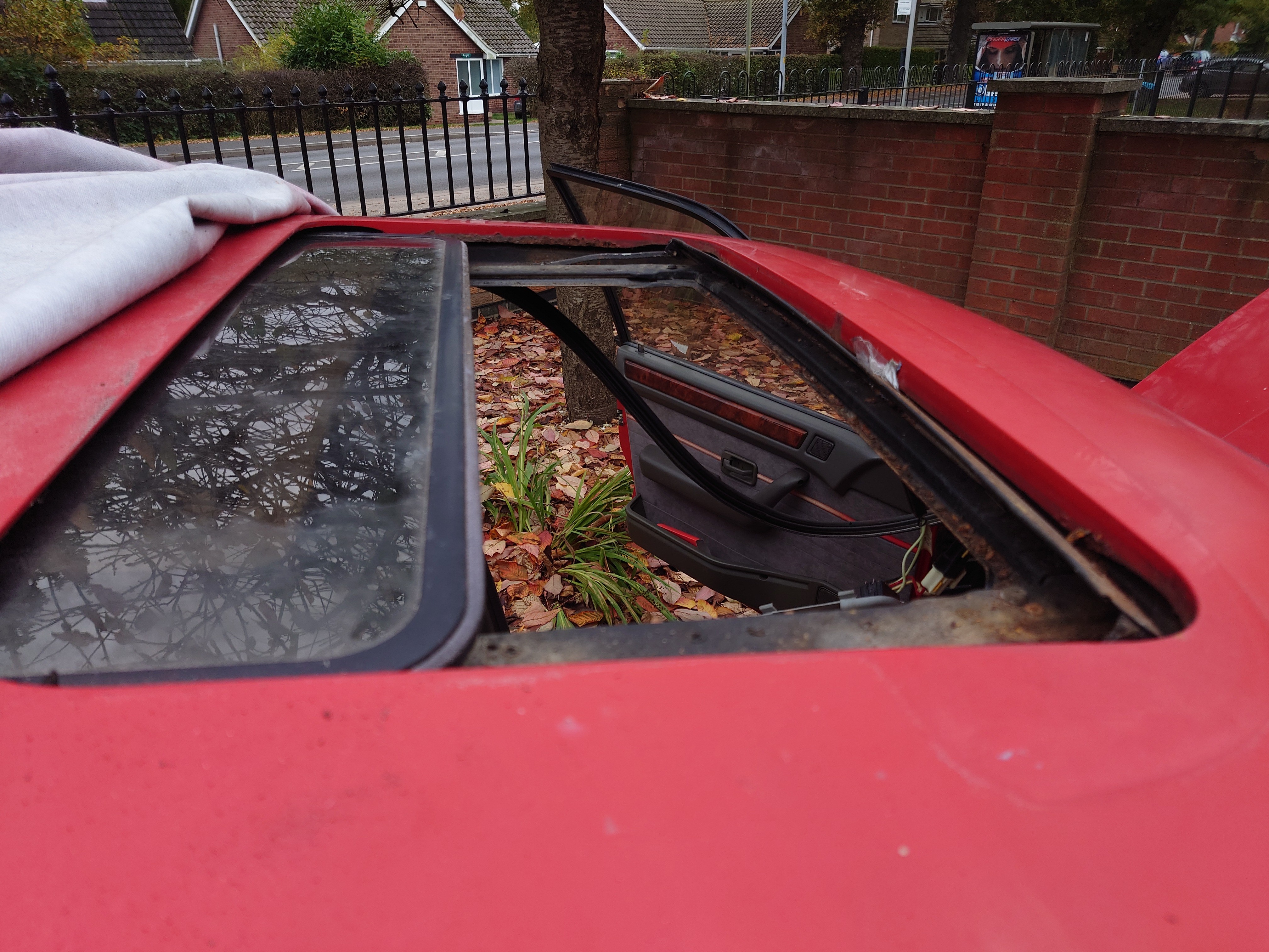

              Started looking at the sunroof not working. There is power to the electrics then noticed this. As the motor is probably broken I stripped the end as I know its the same basically as a dynamo but a tiny spring went ping from one of the brushes and I couldn't find it so that's now scrap, not good and I did swear quite a bit
              After doing a bit of research I found it's the same motor as an early Rover 213/216 and a Range Rover tin topped sunroof up to 1991. Found one complete with a relay so that's on its way

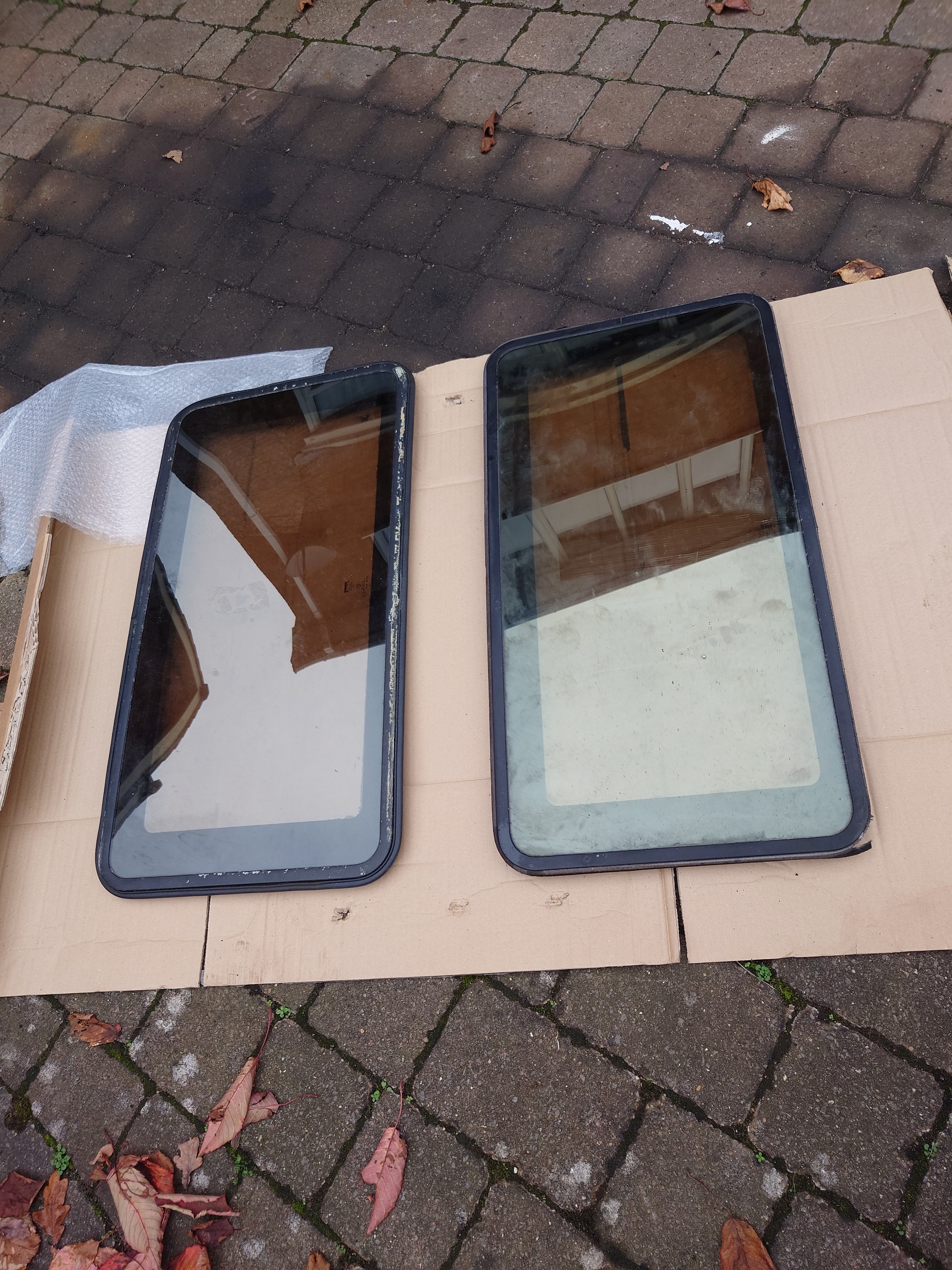

                        • #72

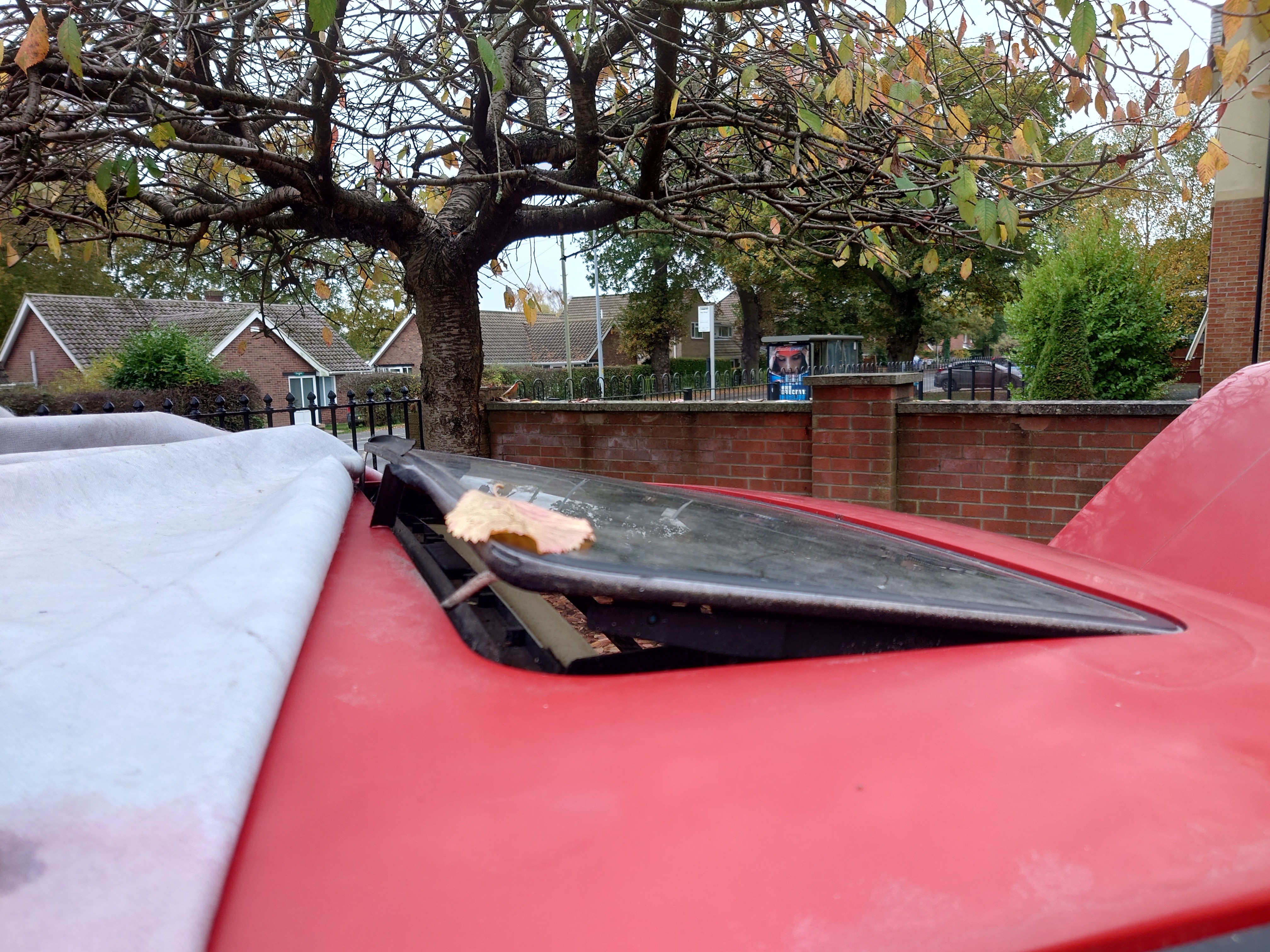

                          Well I did try. Removed the knackered sunroof glass and got all ready to put the replacement in but the seal is too large/thick so the glass is stuck and the motor won't move. Removed the seal from another I have in my spares and ordered another as I couldn't find the one I bought 4 years ago. I sold on a few things 2 years ago and wasn't sure about the seal so ordered one for a mk2 Golf

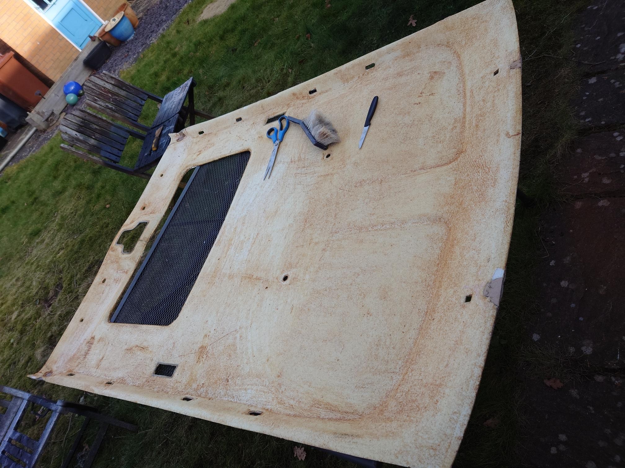

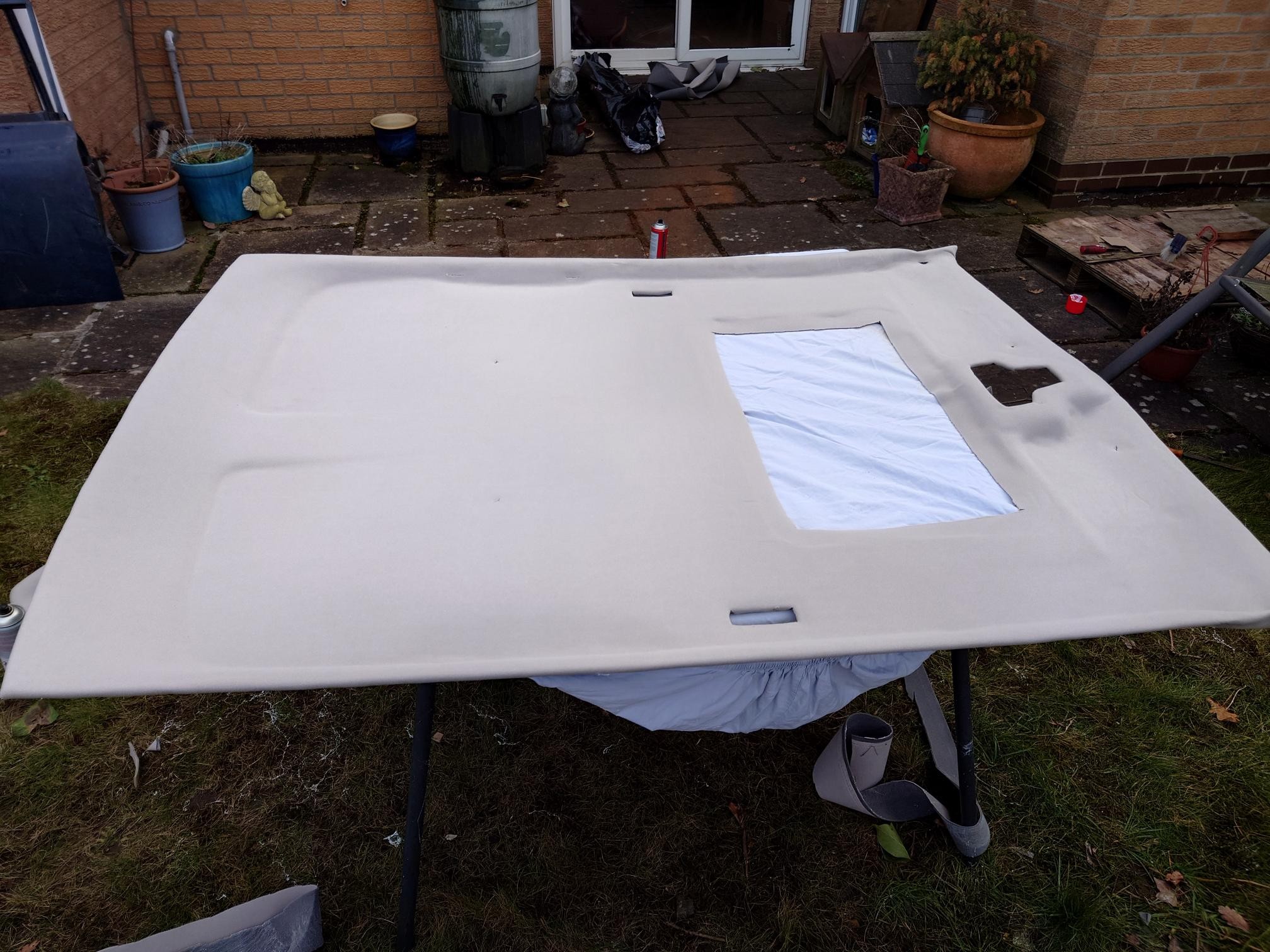

                            sunroof is back in and the headliner is in the way in one of my sheds so I repaired it and re-covered it today and will put it back in the car tomorrow with luck. Will just have to push in a couple of places round the sunroof switch as the picture was a quick one before I tidied it up

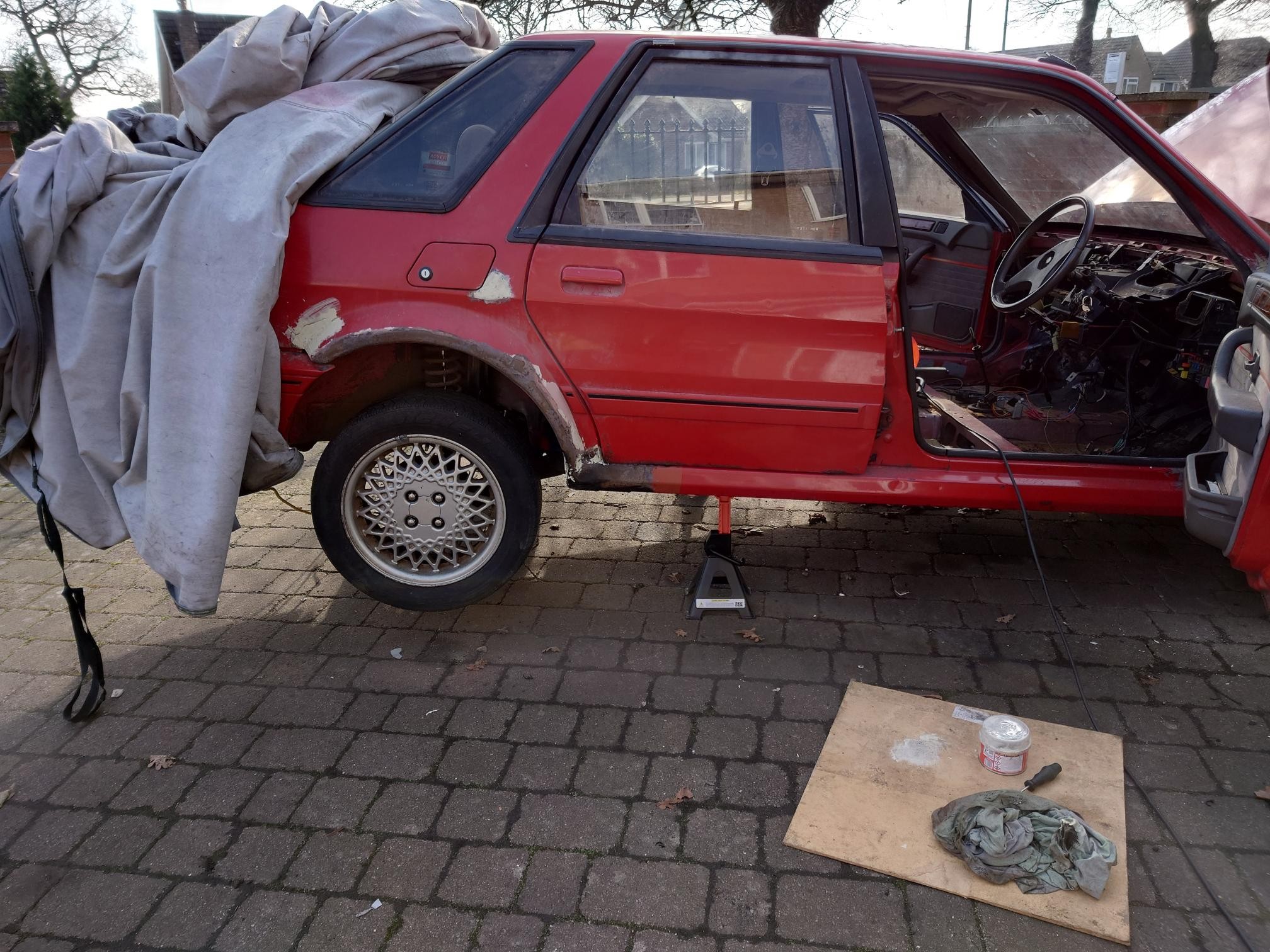

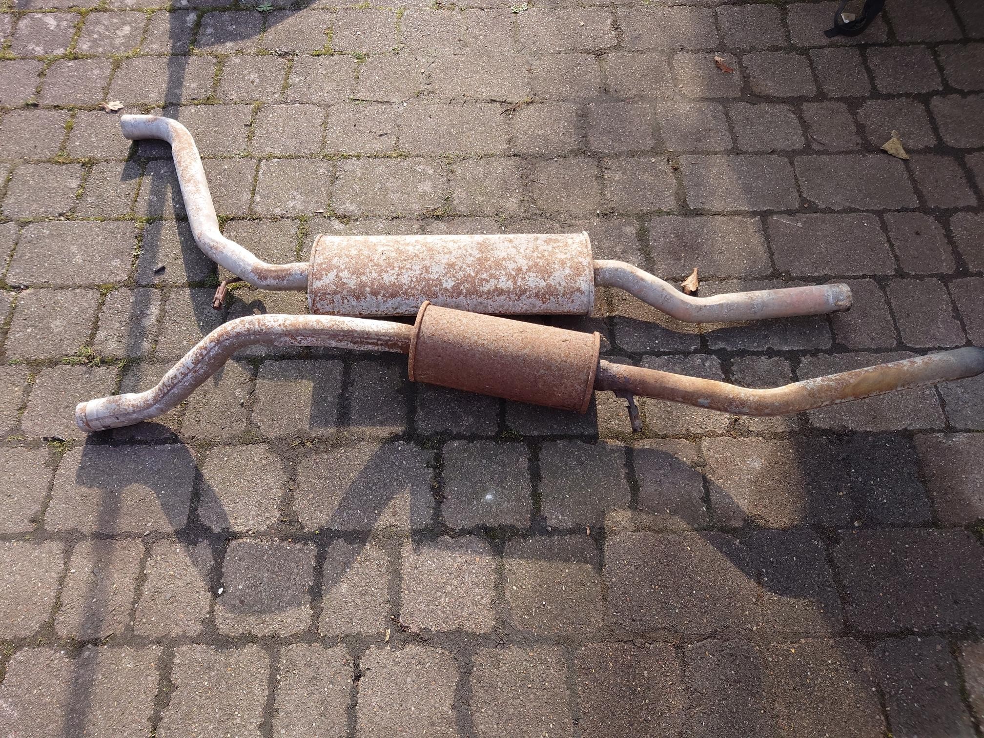

                              Headliner in the car, blowing exhaust cut off and car back on high axle stands to weld up the sills
                              • #75
                                Removed the last part of the exhaust today. The original was poorly fitted and also had a sleeve to join it from the downpipe so I removed it and opened up the hole. Don't have the correct tools so hammered various sockets in it to open it up, now fits properly so once later on will fit the replacement exhaust I've had a few year now, slowly coming together now
