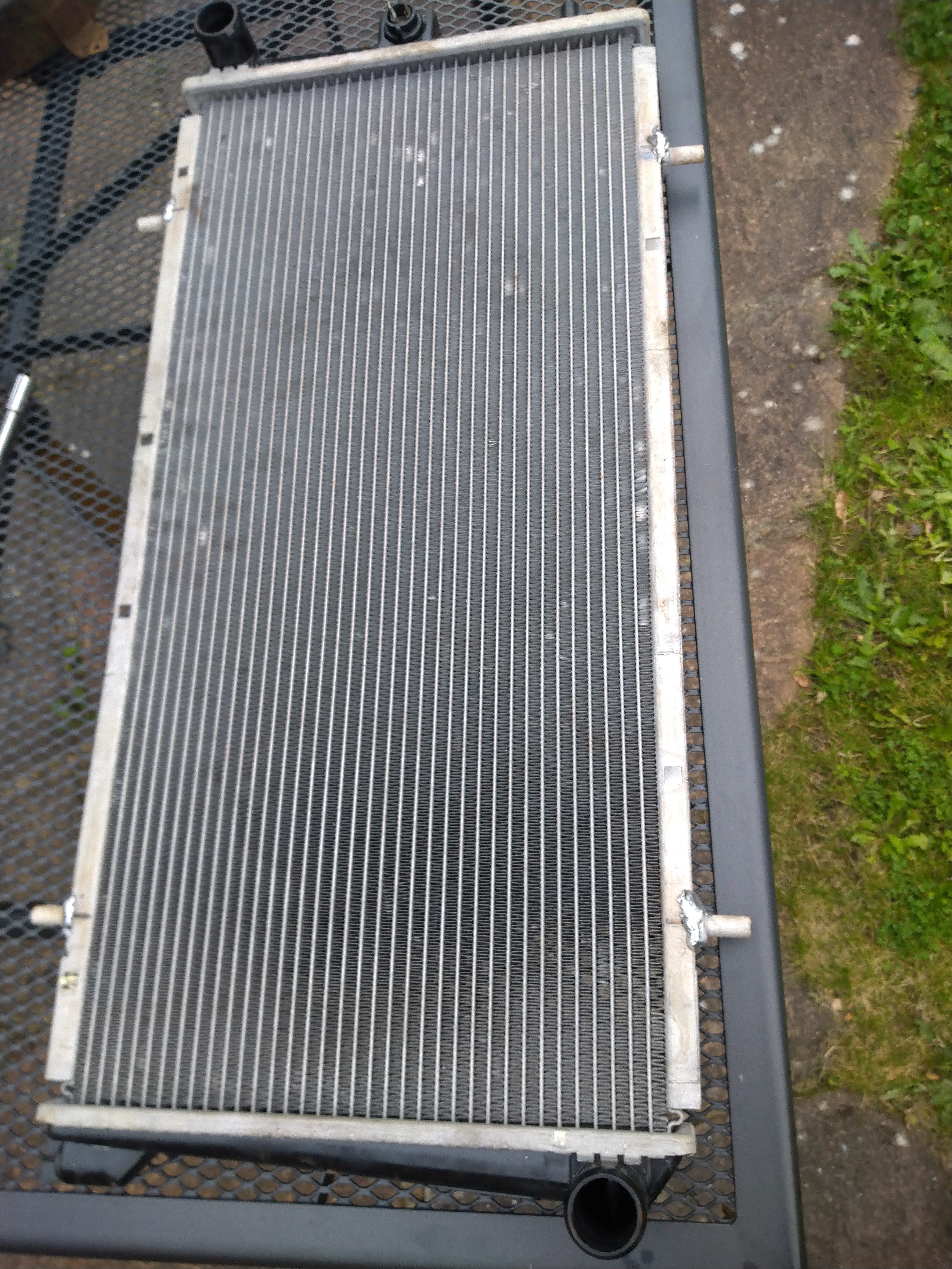

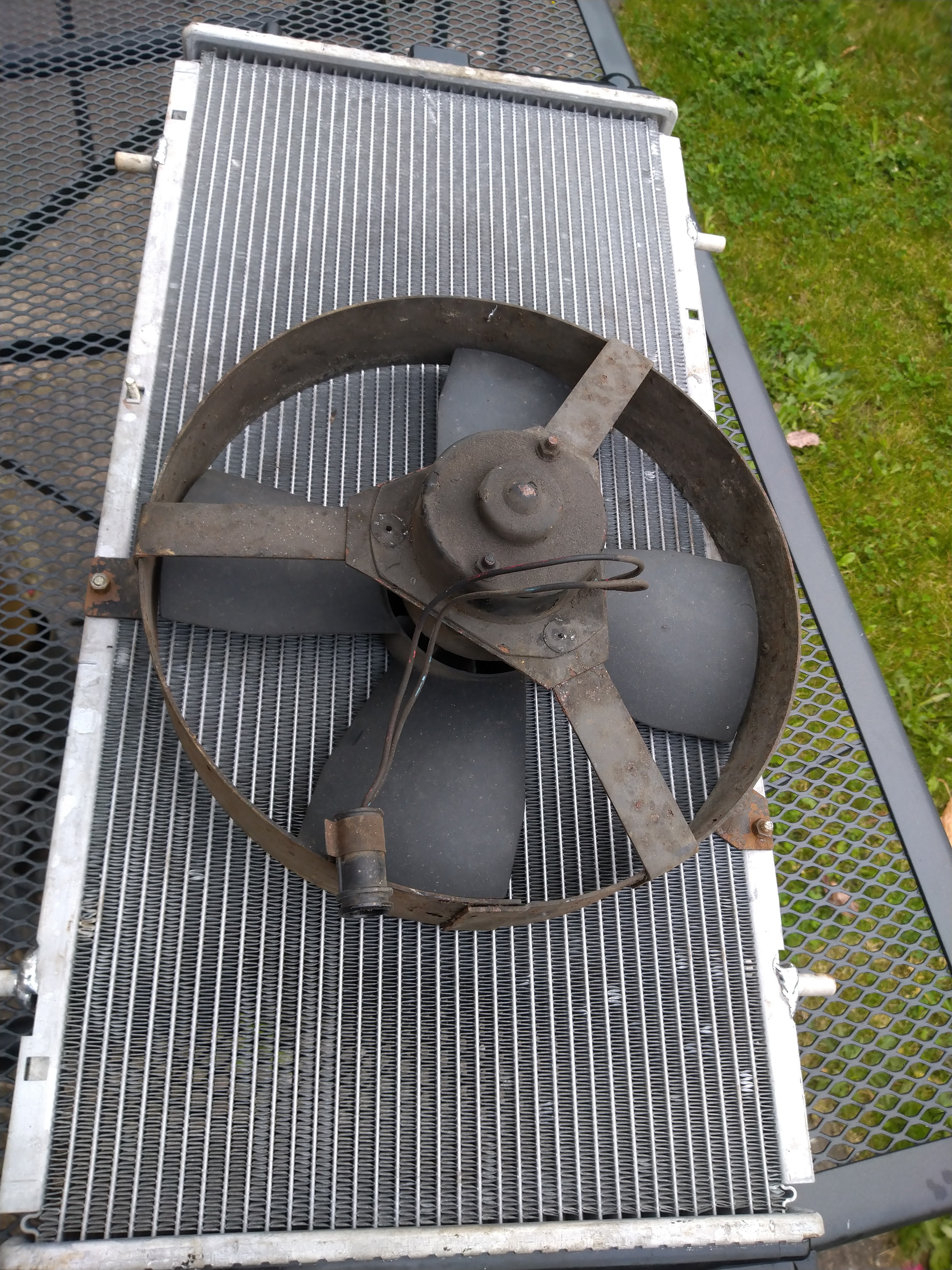

    Replacement rad sorted, mgf one modified

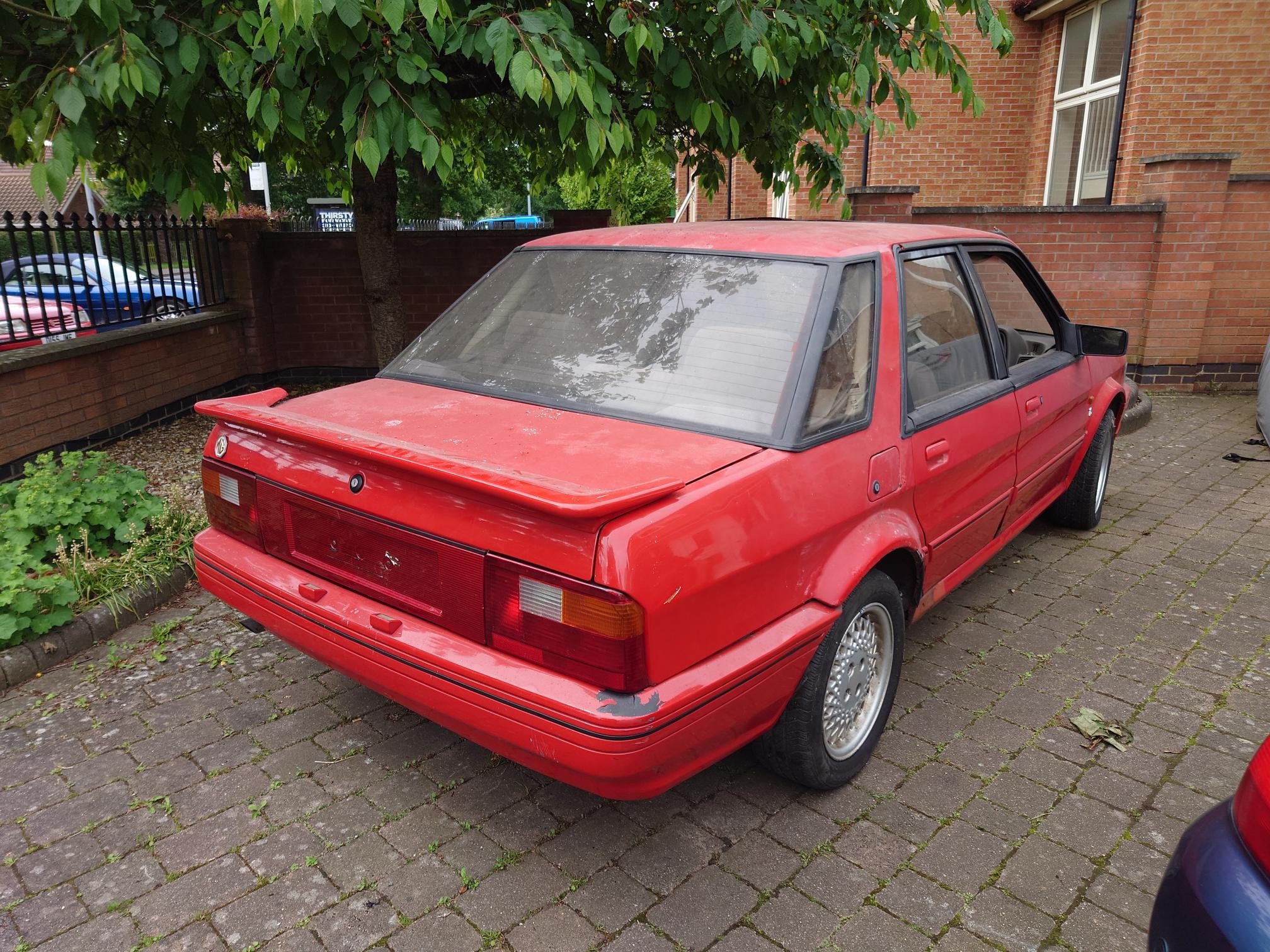

      More turned up yesterday, has had tape over it in the past but looks like a recent seal. Just needing a bit of a clean then this will be going on the car eventually. Many thanks Mick

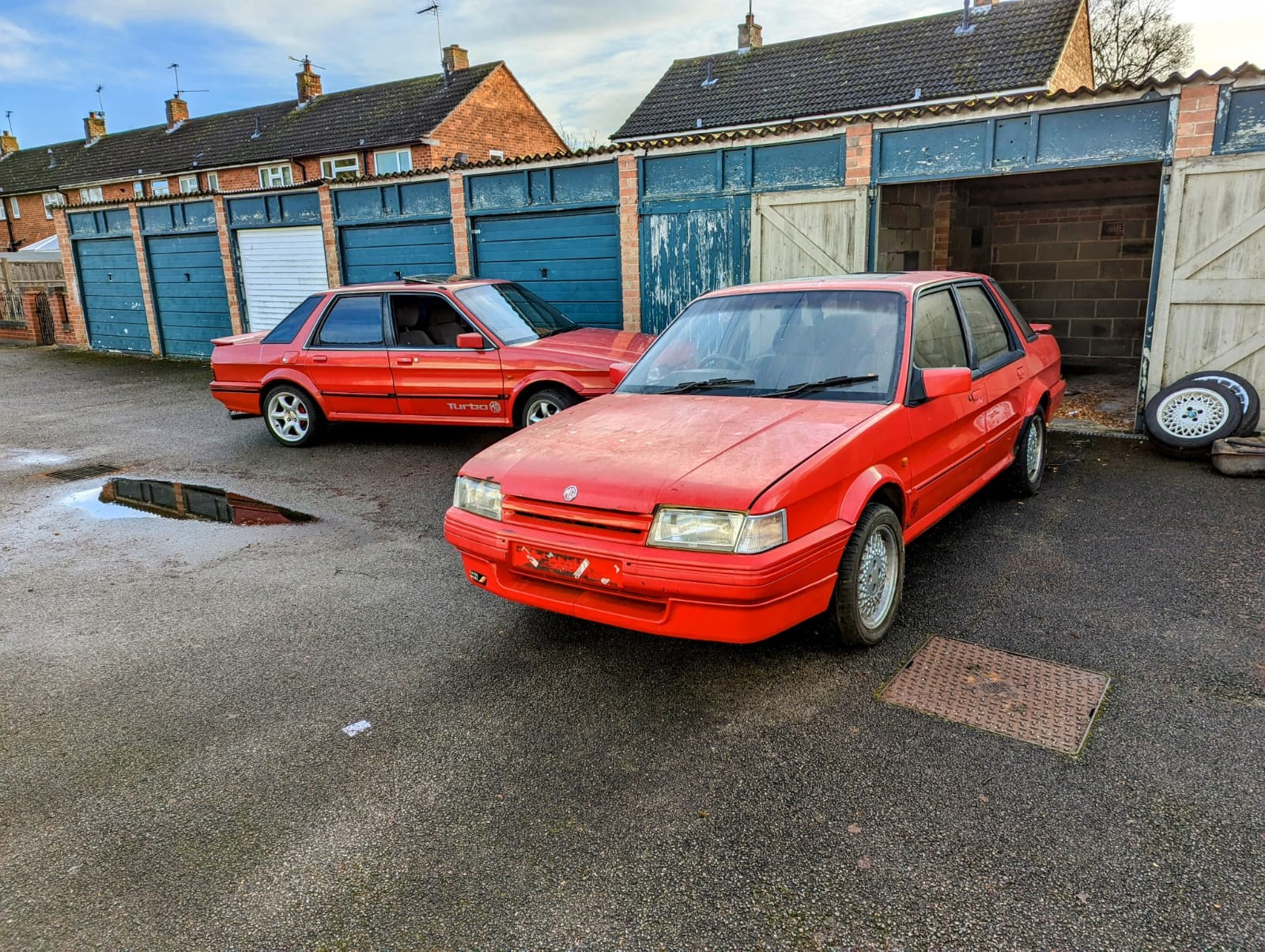

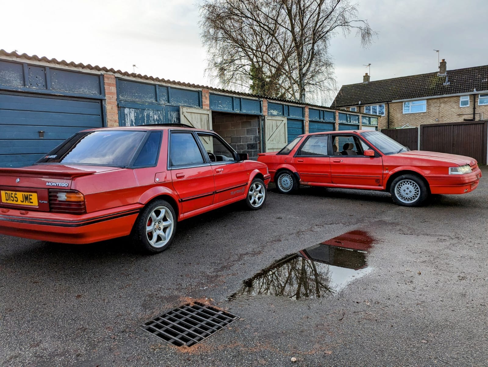

                Turbo now gone off the drive and towed this on the drive
                • #38
                  Doesn't look too bad at all, but it will no doubt find ways to stop you getting bored

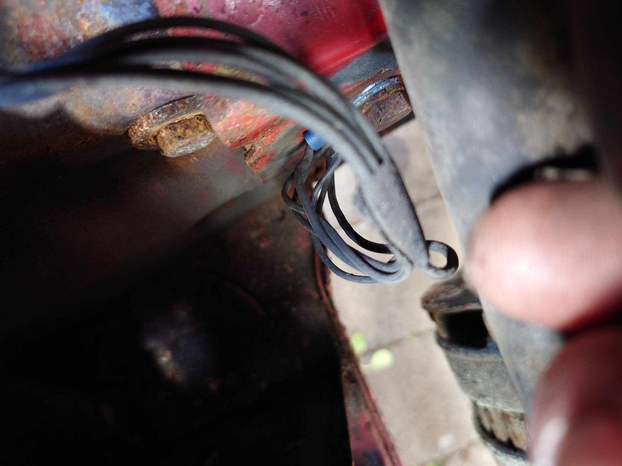

                    Lots of progress today for the hour I had spare, fuel pump finally working now and was due to the earth behind the offside front light. Cleaned up and put a new connection on it and alls working now so the same issue as Alan's Maestro. Needs a fuel filter next and a battery. After that is connecting up the pump properly etc once I get back from hols. Very pleased

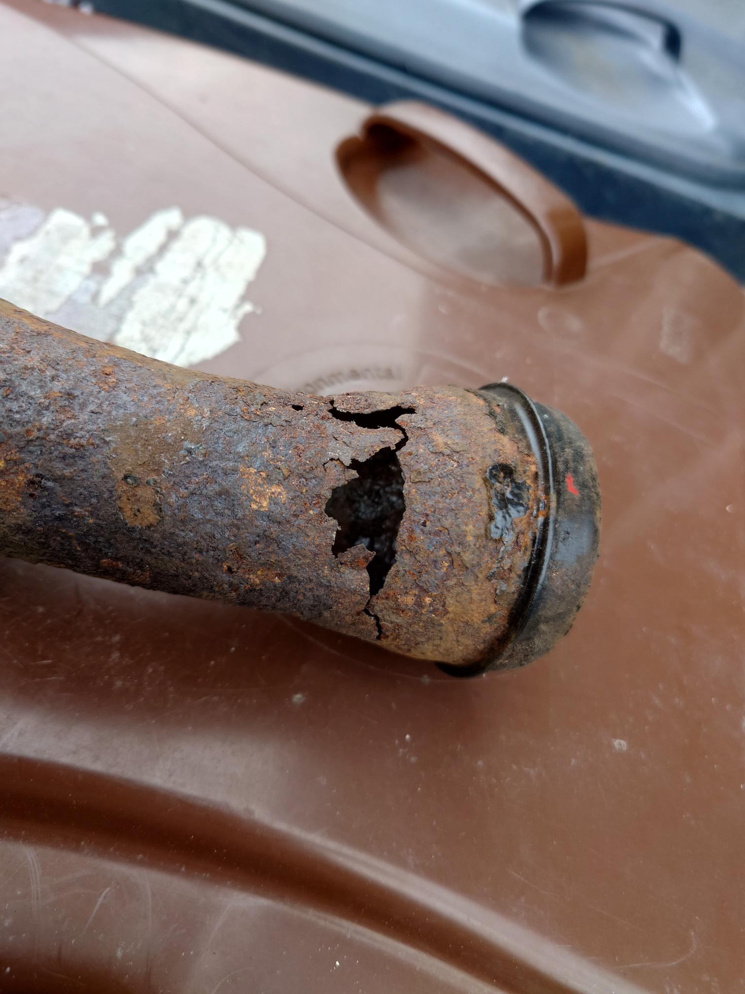

                                Back from holidays now and had a bit of time this afternoon to carry on, new fuel pump and filter on, off axles stands and just about to fill the empty tank with fuel.
                                Saw a bit of rust inside the fuel filler pipe but that grew
