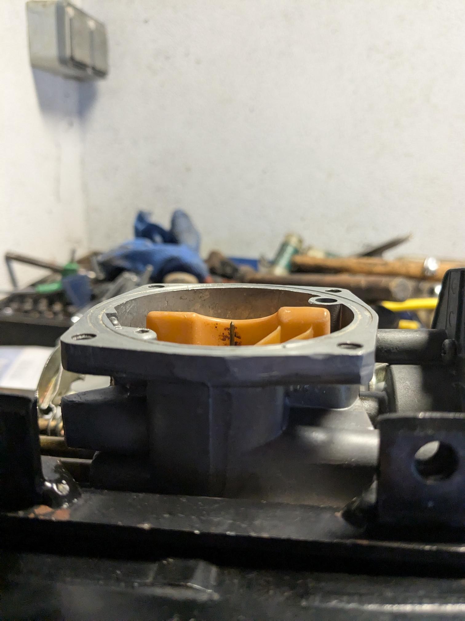

      Thanks a lot Jeff. This afternoon I’ll take out the carburetor and start with the adjustments. How do you measure the float clearance? With a feeler gauge? What is considered clearance? So the steps would be: remove the carburetor, adjust the float, adjust the jet, and then adjust the idle? And after that, install it and do the fine tuning?

          Thanks, Jeff. First issue spotted. The float’s height was way out of position. Following up, checking.”

              Haha totally. Thanks Jeff, without the help of people like you it wouldn’t be possible. Yesterday I started the car with the vent valve outlet blocked. The car idled fine and when accelerating it ran as it should. Now the mixture adjustments are actually making a difference hehe. The carb float chamber must have been so overflowing that fuel was going straight into the intake manifold without being metered. The spark plugs, although new, are completely black from this first start, and I think it’s still not running as smoothly as it should because of that. What do you think? I’ll post a couple of photos of the float height adjustment before and after.
