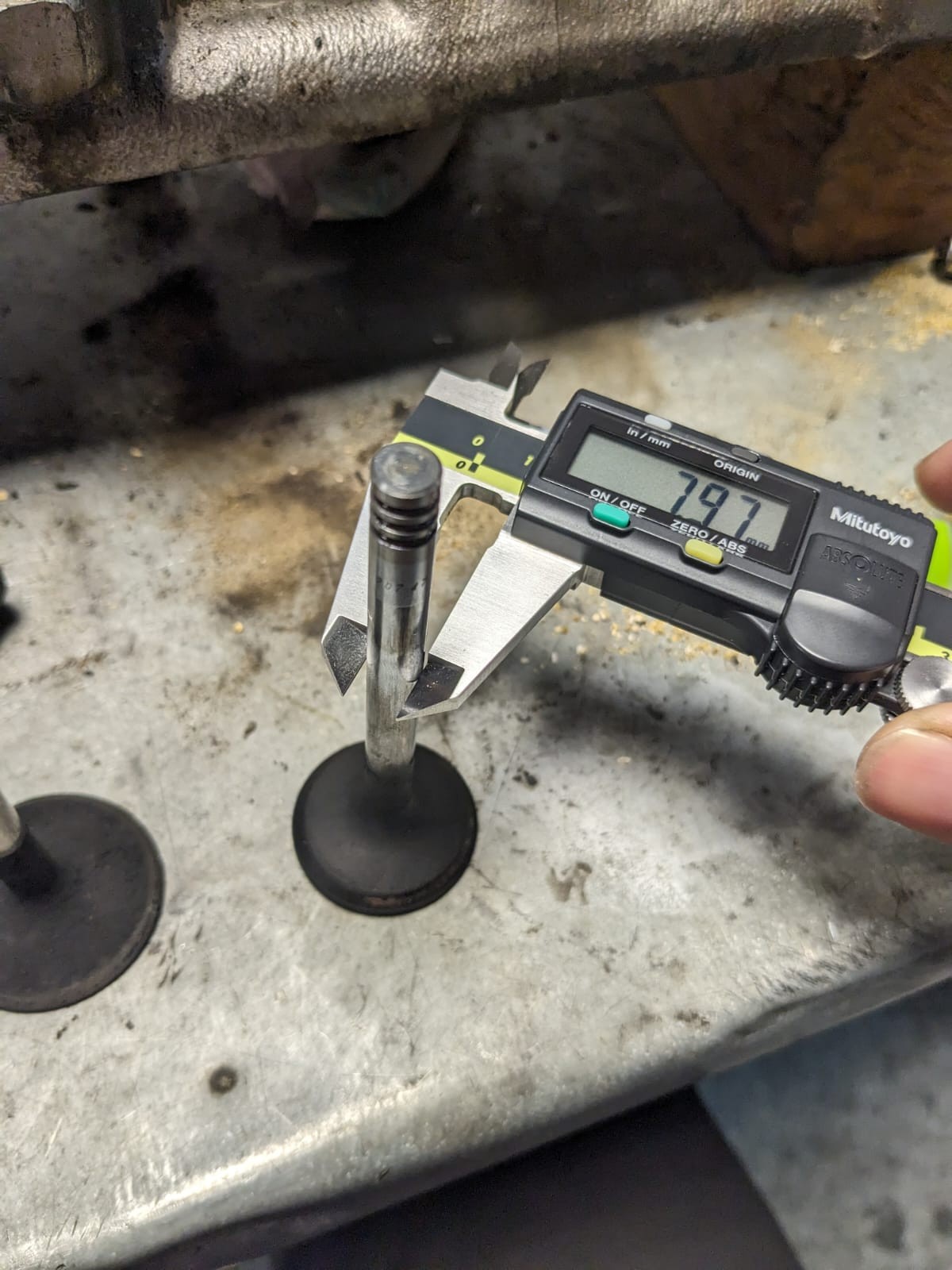

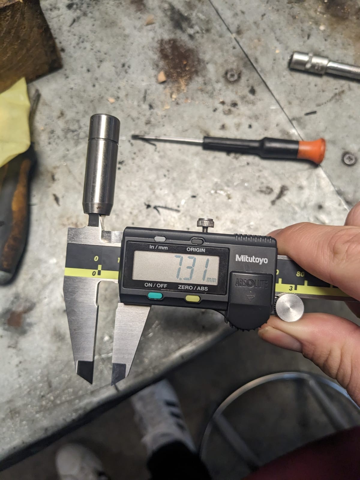

            That's good news! Thanks for sharing the information Jeff. I have 8 new valve guides but the inside diameter is narrower than the diameter of the inlet valves.
            The inner diameter of CAM5821 is 7.30 mm.
            The diameter of the inlet valve is 7.41 mm.
            The diameter of the exhaust valve is 7.96 mm.

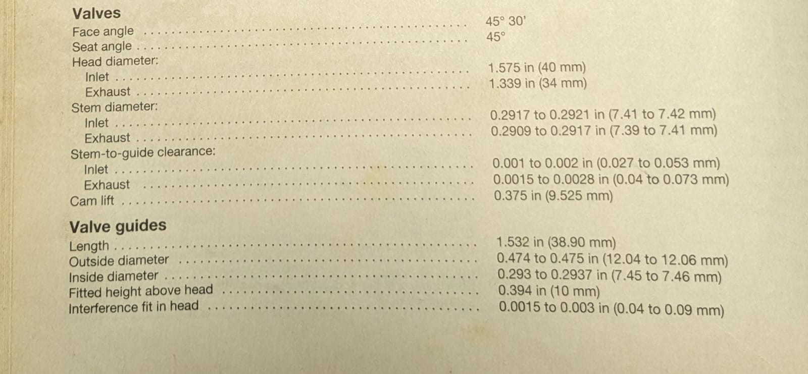

            The shop manual says the intake valve guide tolerance is between 7.45mm and 7.46mm, but I don't know what the tolerance is for the exhaust valve guide.
            Does anyone know what the tolerance is for the exhaust valve guides?
            Should an 8mm reaming fit with the exhaust valve? The tolerance will be 0.04um

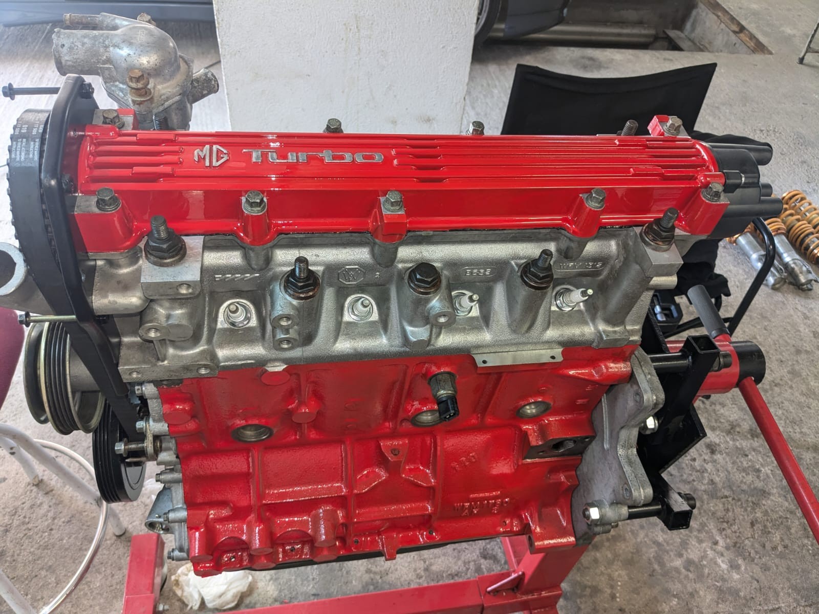

                Hi everyone. These months have been a bit complicated and I have only been able to make progress on vacation.
                The engine is fully rectified and assembled. (Attached is some photos)

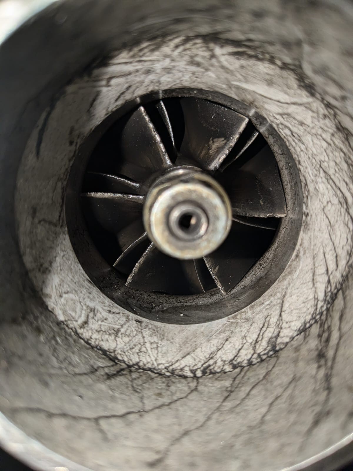

                -Take the turbo and exhaust manifold in for repair. The collector has a crack. The turbo has dented blades and no wastegate. Any advice with this?

                  Looking good that and coming on
                  This is complete so you may only need to sort the turbo unit on ebay The oil switch on your oil pump looks the wrong shade of green. Is it a turbo oil switch ? If not the car won't start when you put it in

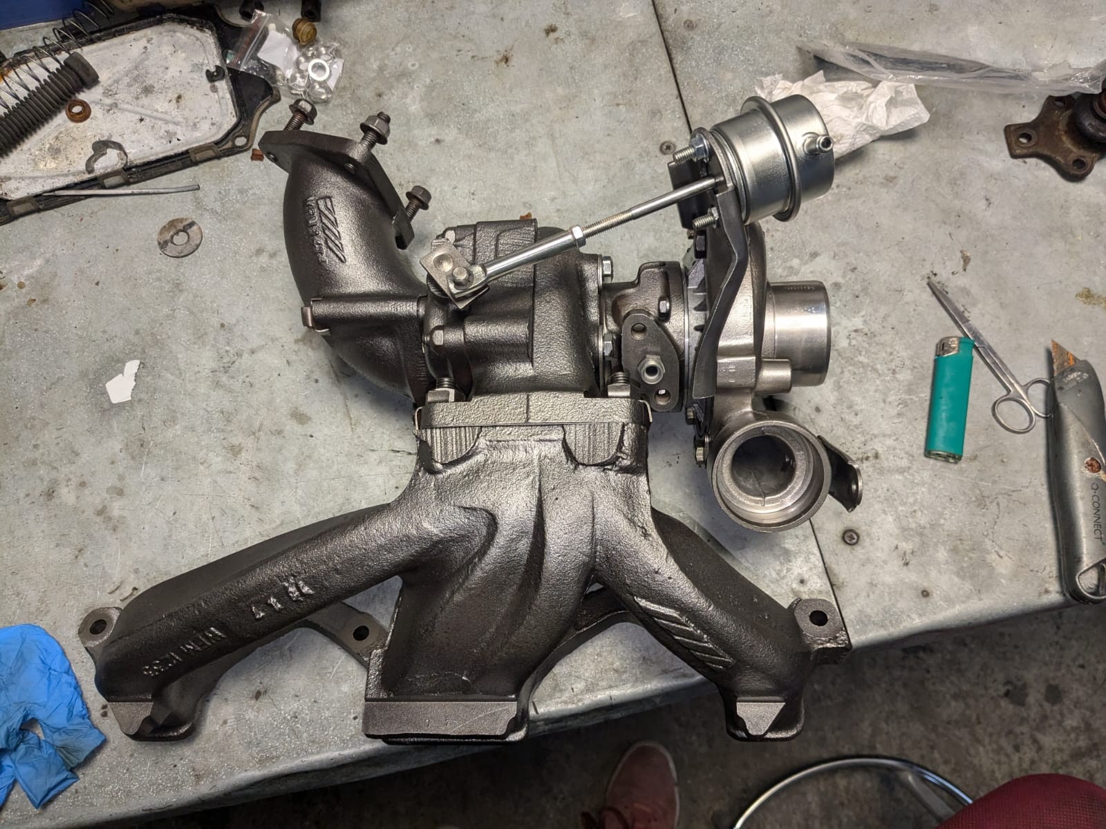

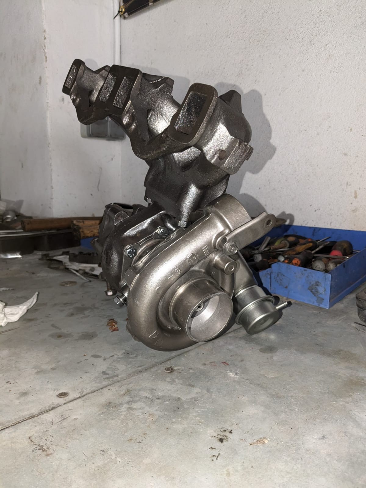

                        I have located a company that can weld the exhaust manifold. I will take it to repair on Monday
                        Yesterday I picked up the newly restored turbo, I attach some photos. I am quite happy since they have decarbonized and sandblasted everything in addition to the reconstruction itself. Also, they have gotten the westgate

                          Looking good there
