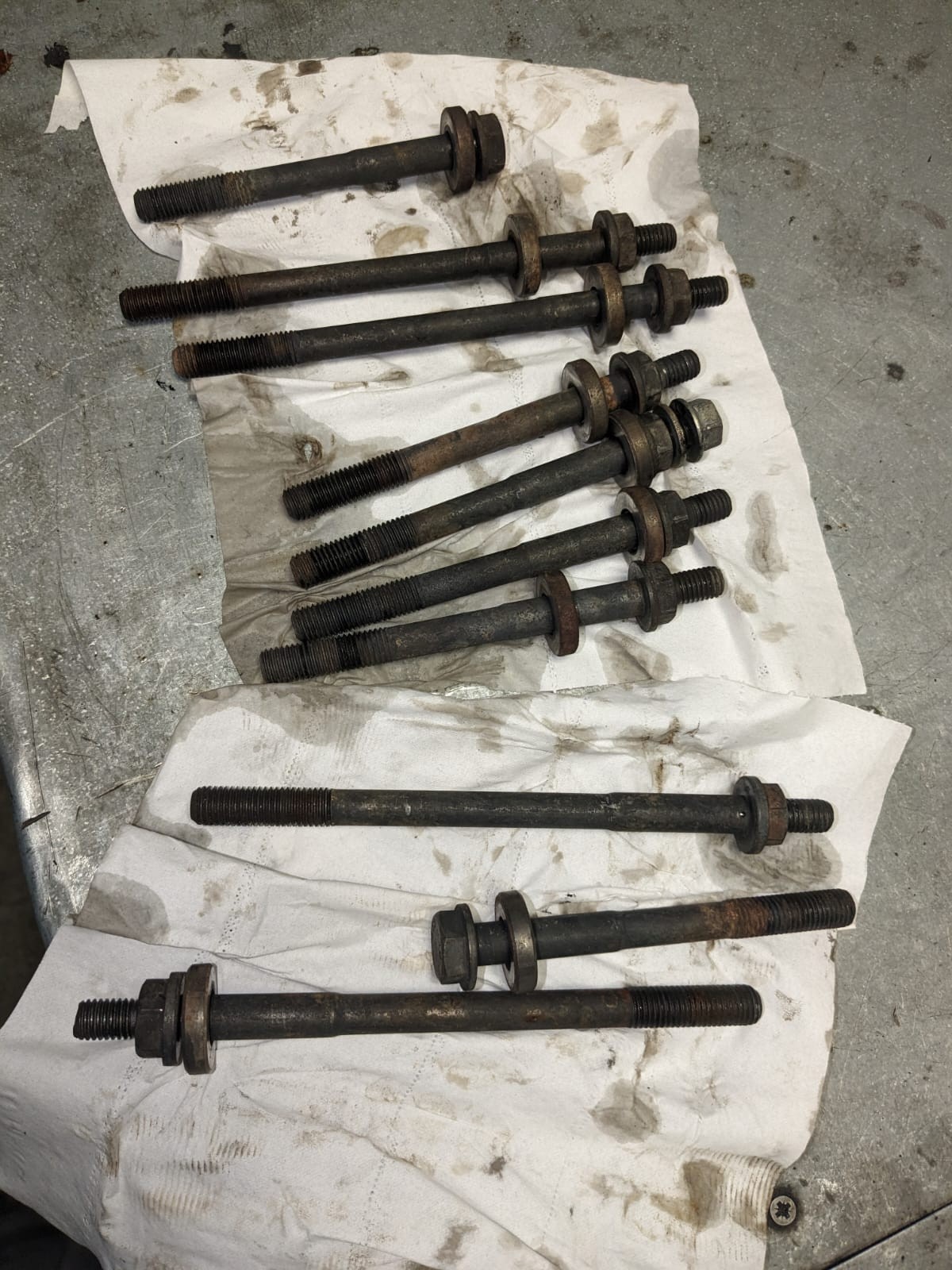

          Yesterday, I progressed with the engine. Cleaning parts and bolts, putting up the engine in a support, and selecting the best bolts for the head(I have two bolts set) what
          ​​​​​​size are the head bolts? M11x1,5 or M12x1,5?

            Other than a washer missing I can't see anything wrong with those head bolts, a clean with a wire brush should be enough. Teeside have a turbo headgasket on their website GUG702594HG, put the number is that website Teesdale Classic Car Parts Centre - INRacing I don't have info on the second number with it GUG2516HG but from memory I think that's the manifold gasket you need from the unipart number. The guys name is Jim so contact via the website, Jim only works mondays but can be contacted via the email address as he looks at those in the evenings, if he does have that gasket then that's the one for you but check first

                        The correct size of head bolts is M11x1.5. All the head screws are brushed and clean.
