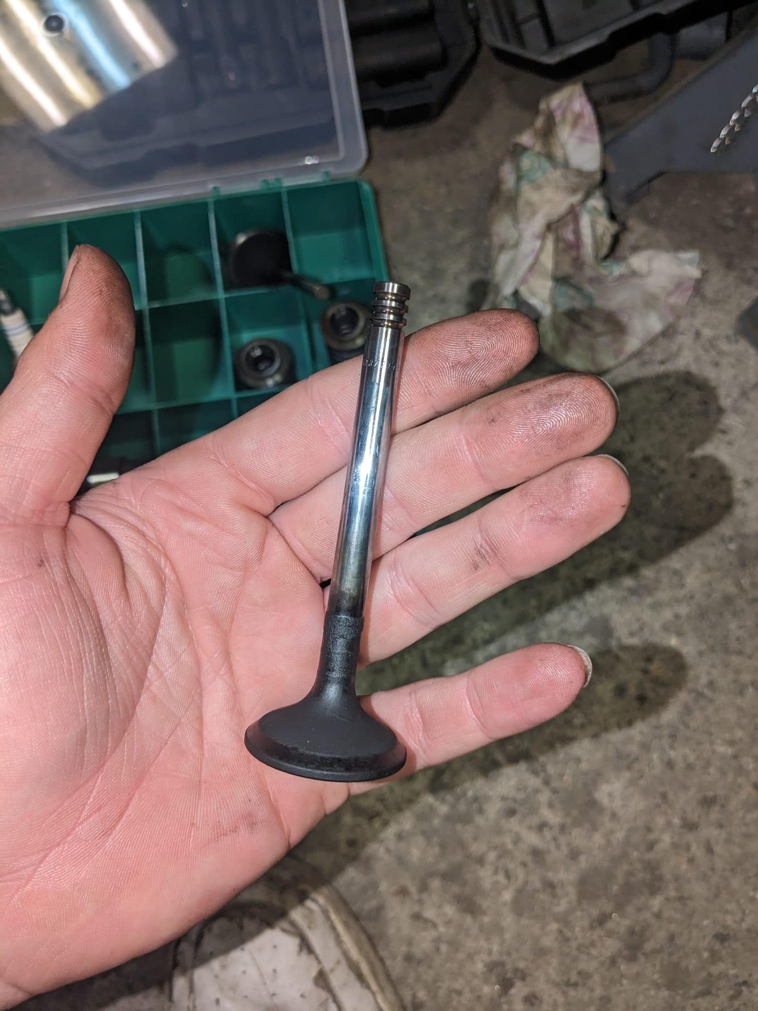

                          • #58
                            Yesterday I disarmed the valves and took photos of valve seals. The cylinder head is a earlier type as you was told me so this valve seals should fit in my cylinder head, right?
                            https://rimmerbros.com/Item--i-AHU1626A
                            I have located the intake valve guides but noy exhaust valve guides. It is possible to machanize a new ones?
                            Thanks in advice
                            • #59
                              Thanks in advice
                              Yes those are the correct inlet valve seals as it's the same link I put on for you in post 52. Exhaust valve guides yes can be fabricated if you have the sizes.
