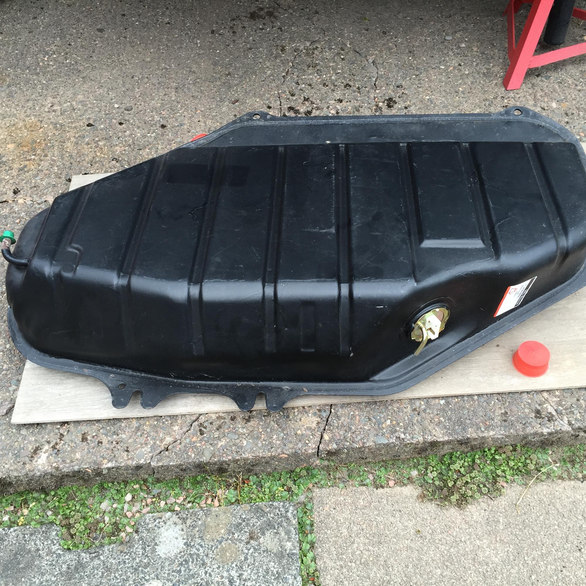

            I'm going to run separate fuel feeds to carb and injectors running from one swirl pot. I may need a bigger swirl pot than the 2ltr one I have now? Below is a 1600 fuel tank thats just about to get a fuel return added. Pictures of that later. Swirl pot needs modified with additional fuel feed for the second 044 fuel pump.

                • Just a wee update - fuel tank hopefully will be ready today after modified fuel returns are fitted. Swirlpot also modified to handle two bosch 044 fuel pumps.

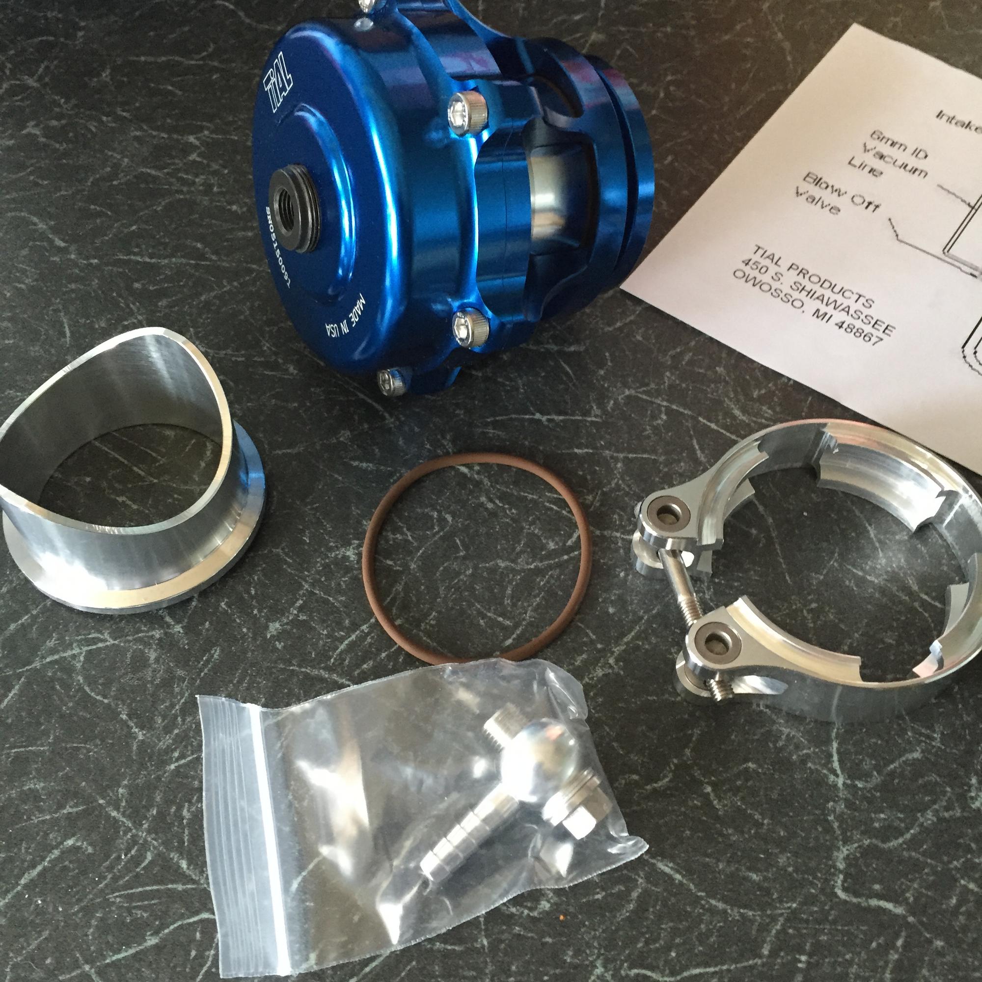

                  • Got this massive Tial dv from Owen Developments and a high capacity alloy radiator from Radtec.
                    Almost have all the parts for my twincharged project now. The m45 supercharger with the air con clutch pulley I was going to use wasn't practical to do. Going to change to a bigger m62 with a already built on clutch - the m45 is for sale on ebay now if anyone is interested. Update on fuel tank soon.
